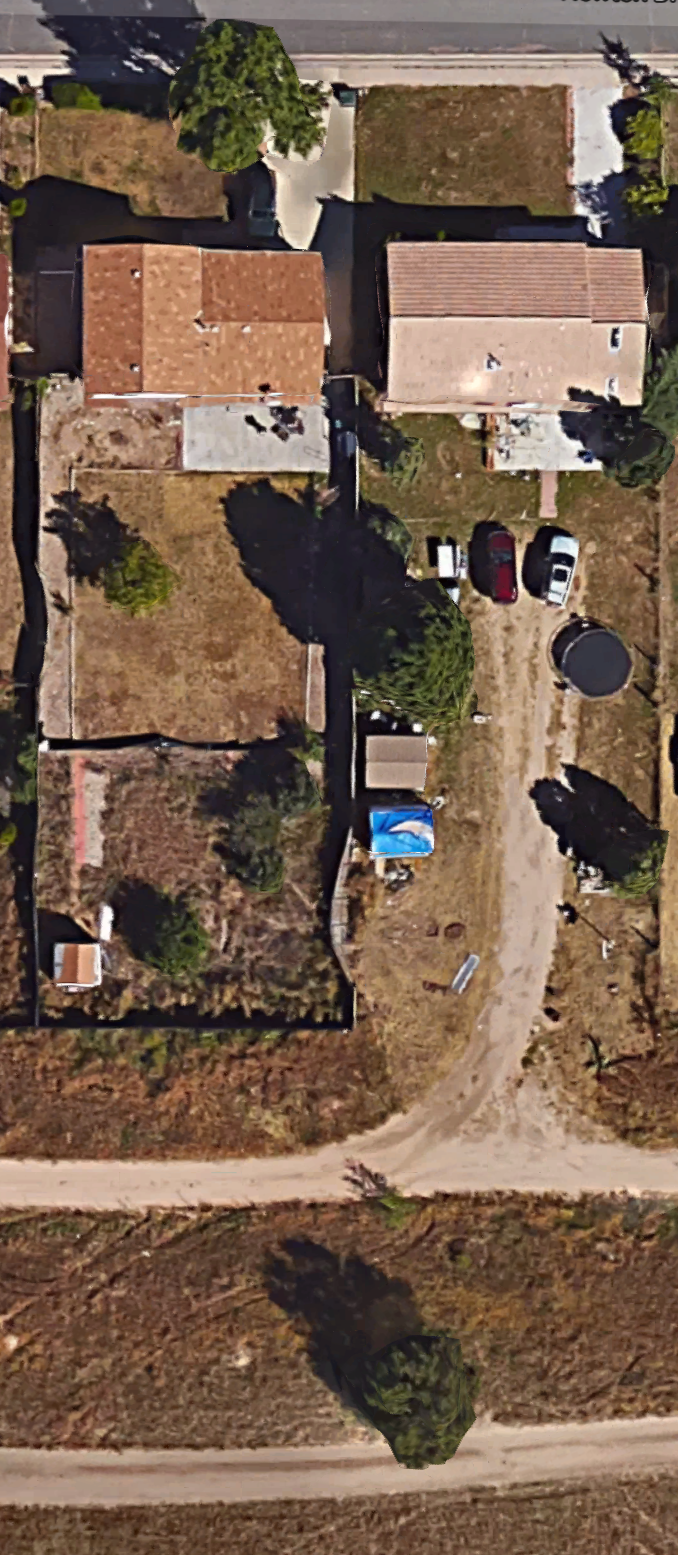

I've got 3x small properties. House on a 70' wide x 105' deep lot. Then two houses on a 123' wide by 180' deep lot.
All 3 back up to an unmaintained ~8 acres of open space. People walk their dogs back there, jogging trail, ride ATV's, dump trash, utilities access, etc.
The landowner put up some no-dumping signs and barricades. They've mostly been torn down, and I've started rebuilding them.
I've got a 2016 BX2370 with a Land Pride PD10 Post hole digger. Works great for my fencing projects and to stand up a bunch of leftover 6x6 landscape timbers.
I'd like some rear ballast for the FEL. I'd also like to reinforce the grade on the ~22K square foot lot. I assume it was all good at one time, but previous owners had kind of made a mess of it. Lots of "deferred maintenance".

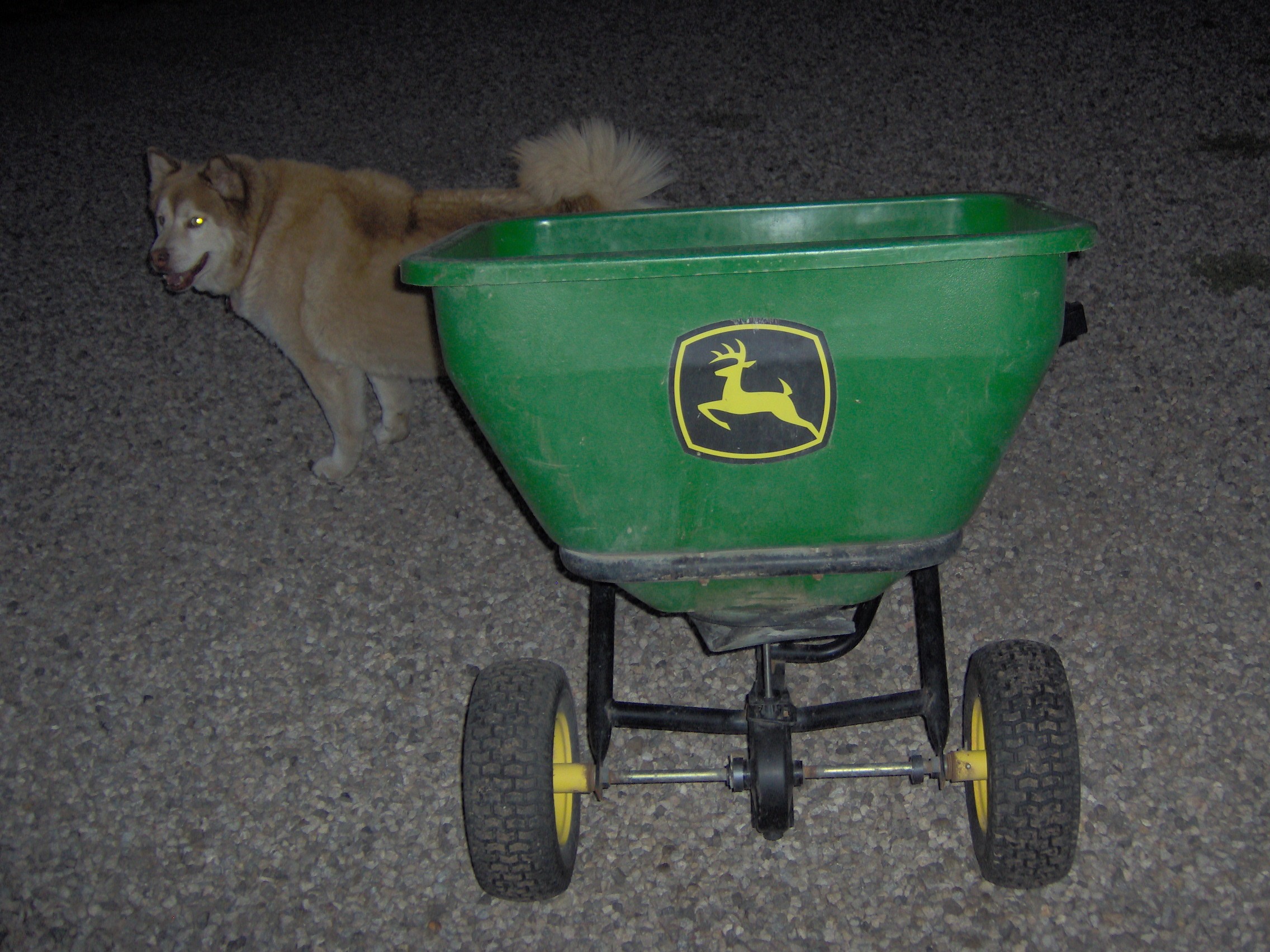

I use the x749 to work around trees and in tight spots the larger tractors can't fit. This helps reduce the amount of hand work tremendously. Here are some of the implements I find handy for working up a lawn.

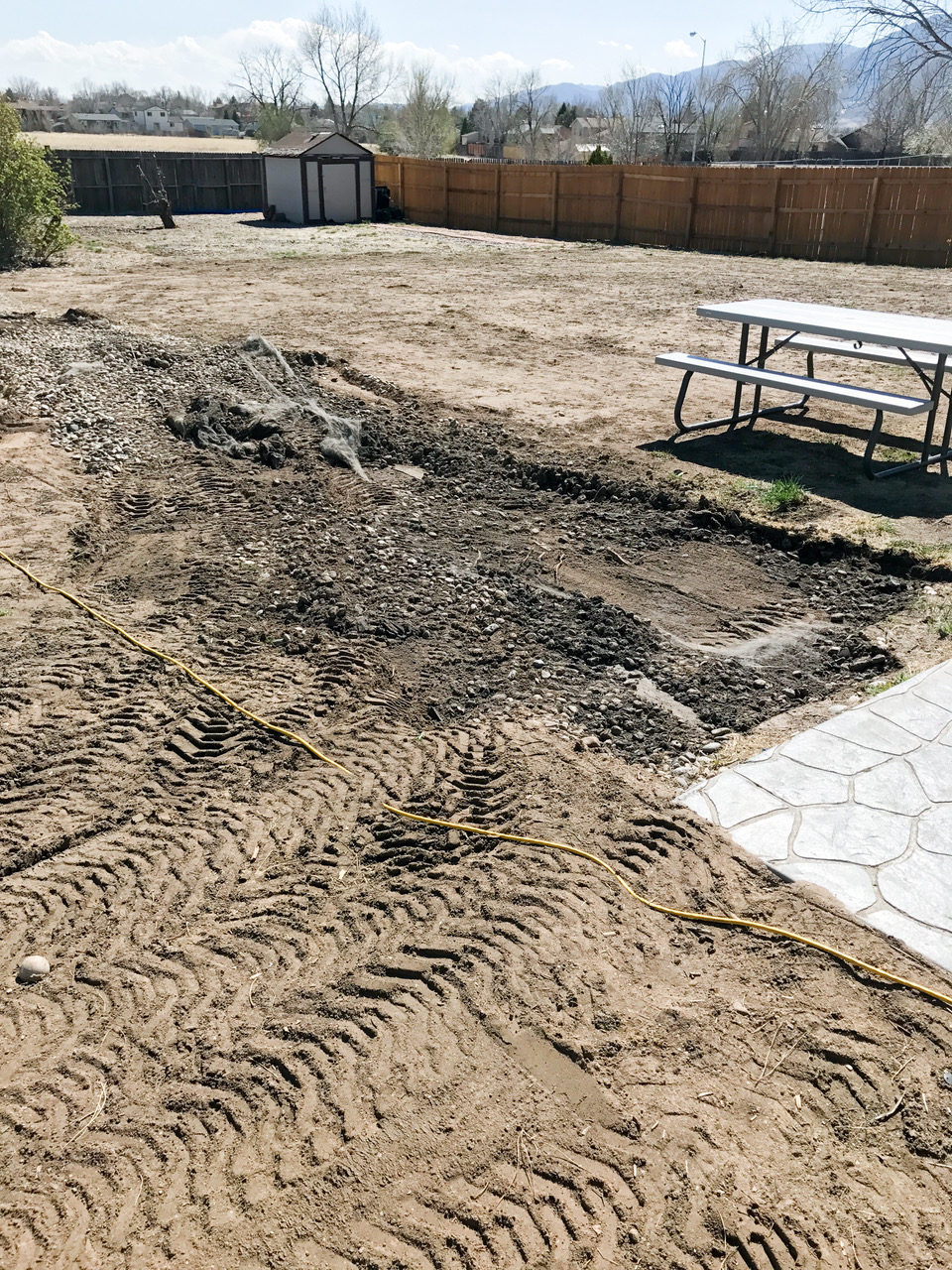

The most-current driver was to address an existing negative-grade issue. Last year we had water in the crawlspace. I wanted to get that area built-up before the Spring rains (that haven't happened).
I've kind of lost count, but I think I've dumped about 12 yards of fill dirt in that area. I'm to the point trying to smooth it out / "grade" it and have been back-dragging the loader bucket.

Since I filled-in the the one area with dirt and scraped the other chunk full of dead sod -- it's now just all dirt / dust.
Was a muddy mess after the last snow. I had been toying with the idea of spreading out some wood mulch until I decide what to do with it.
