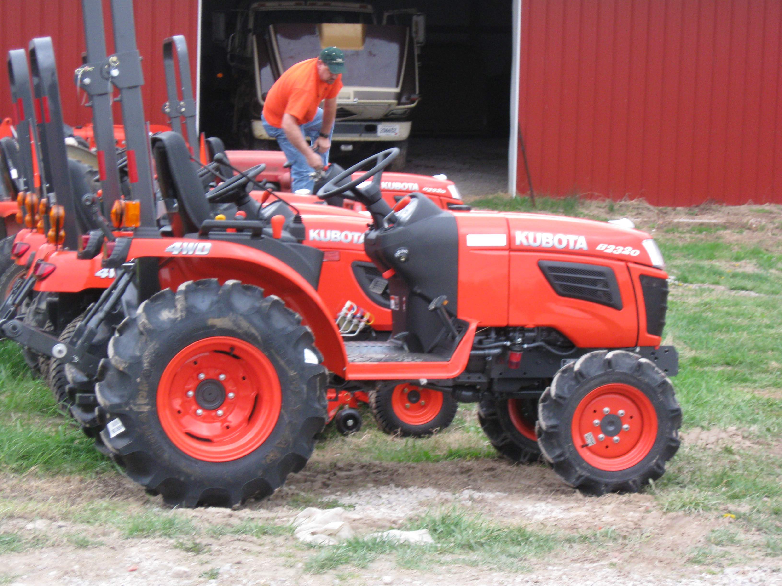

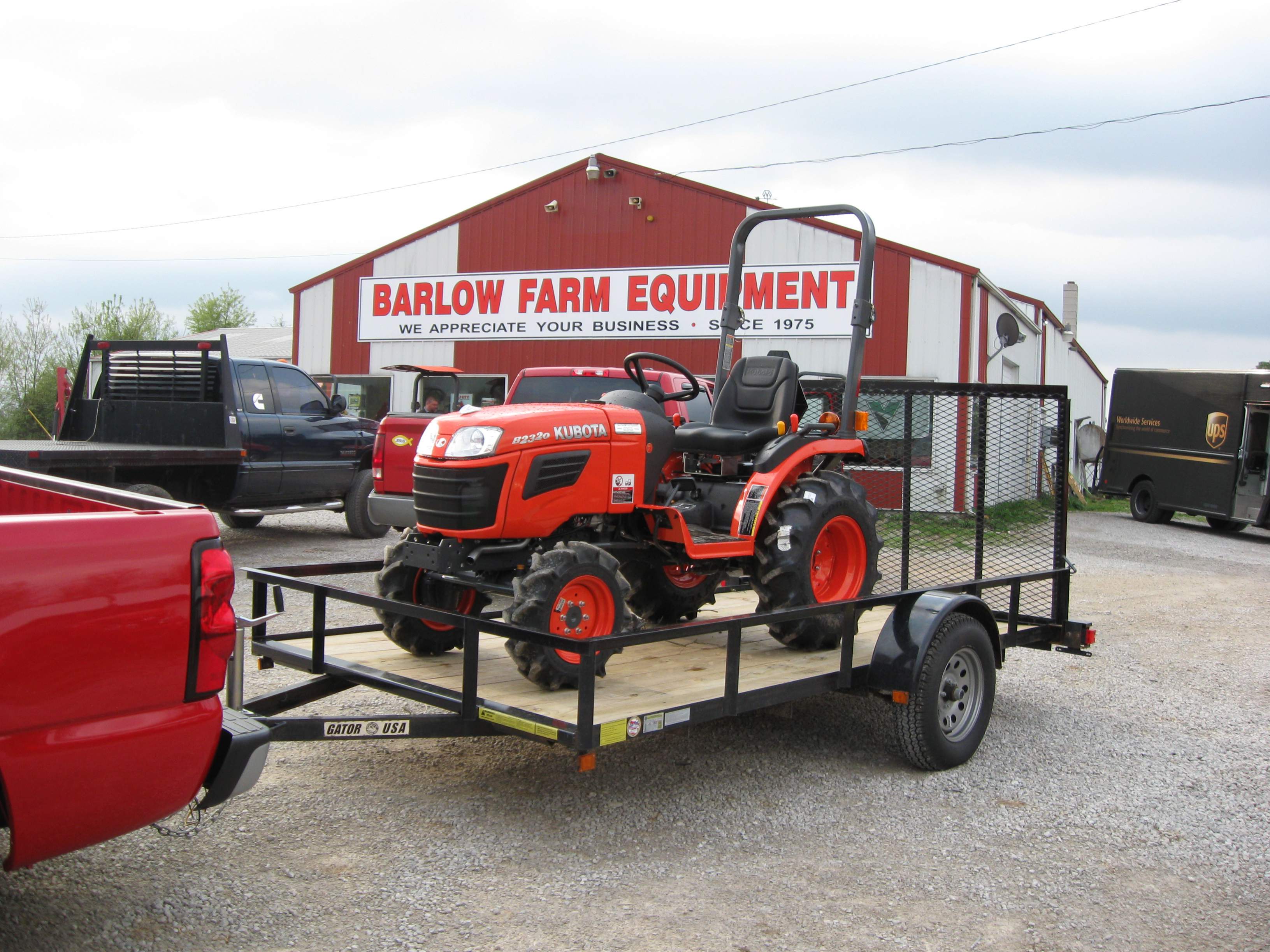

I've had and still have several Kubotas. I currently have a BX25 which is the BX2360 with a FEL and Backhoe as standard equipment. I also have a B2320 which is the comparable B vs BX model.
The BX will feel safer on the hillsides because it sits a bit lower than the Bs thus giving the Bs the higher ground clearance and the BXs less. If your careful and go straight up and down hills as much as possible and not across them you'll be safer on any tractor. I have about 5 acres I mow and maintain and I'm convinced the BX will handle all of your jobs. If your fields are rough then you'll have a bit of a rough ride on either the B or the BX. My front yard that's a couple of acres was a field that I've mowed for several years with BXs and Bs and currently mow with a Kubota F model. It's still rough.
Price the B2320 vs the BX2360 and see how you feel about the price difference between the two. Get turf tires for either for a better ride and R4s for a bit stronger puncture resistance but a bit harsher ride.
