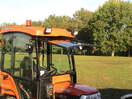

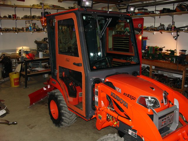

I did look for Laurin Cab last fall. There cabs are well made but quite expensive, but you have what you pay for. The Eclipse model matches very well a bx2350. For a base model, you will pay $5250 CAD and $6500 CAD for full equip one.
For my set-up, I took a soft Curtis cab and I modify it. I did want to able to remove it during summer. With a Laurin or Jodale Perry forget it to put on and off easily.

Hmmm, Looking at those first 2 photos, seems like it wouldn't be possible to operate the bh with that hard cab on. I presume there is no rear panel that just opens up? Taking that hard cab on and off for winter and summer work seems like it would be quite a task and require a sizeable hoist suspended from a substantial beam at a considerable height.

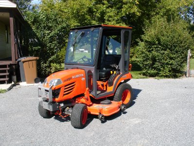

Here are some pics of my set-up for under $3500CAD and few hours. It is removable in 3 hours works great.
Nice setup Skippy!
So when you say removeable, you mean the soft doors and you leave the rest on right? The reason I liked the Jodale was that there was a member on here with a rear steering front mount mower/blower who had one that just came on and off in one piece. Thought it would be kinda nice.

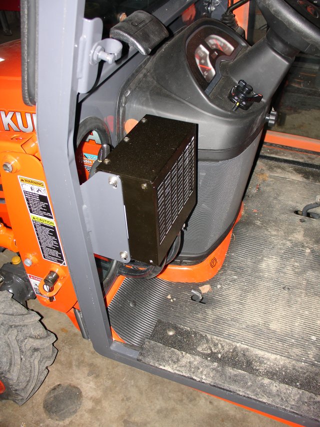

Did you get the heater for yours?
I unscrew 6 bolts, disconnect 3 electrical connections, unplug 2 hoses and raise the entire unit off the tractor. It takes me 2 hours to remove it. Next spring I will do a dolly to moves it around the shop.
I install an cab heater that purchase from Simms.

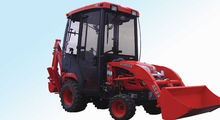

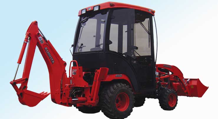

O.K. So in post #2 of this thread, the first 2 photos are of a BX24 with a hard cab. If that cab is not removable, how do you operate the backhoe? The single swivel seat is inside the cab. The bh controls are outside the cab with no space for the operator to even stand, much less sit. I still cannot visualize how one would operate the bh???????
The B3030 has one seat for the tractor and the bh has its own seat outside. I just don't get this BX24 with hard cab and bh????? The only possibility I can see is that the top is hard, the glass is hard, but maybe the skirts at the bottom are semiflexible with the 4 sides being removable and the top staying in place????????
/ BX2350/24 Laurin Cab #14
It is removable but takes a lot of time to do so. It is not design like the soft cabs, removable quit rapidly. The sales clerk at Laurin told me that there a back glass that open and hold by two cylinders. There is also a panel at the bottom that is removable so you can turn the seat around and does the BH stuff.
