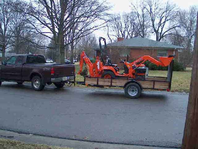

Danny,
Here's a pic of my BX22 on a 12' trailer. As you can see, the trailer's just a bit too short. It also had too much tongue weight (although not enough to create handling problems in my truck at or below 55 mph).
The BH just barely cleared the ground, whether going forward or backward on to the trailer. I believe the ramp was 4'.

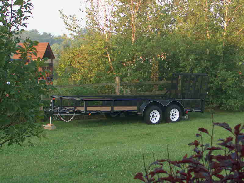

   / BX23 with hoe and FEL owners #3
Here's a pic of the 16' trailer I just bought. Again 4' ramps. I haven't hauled the tractor with it yet, but it should do just fine.

I looked at a trailer just like your new one, but was concerned about the tailgate/ramp not being beefy enough for the 23 with the hoe, MMM, and FEL. The one you have has more bars in the tailgate though. I believe this one had only 5. I measured my tractor in full armor, 15' plus or minus an inch or so, I am hoping to get an 18' since I may want to haul the tiller also, or something else along with the tractor. I guess if I dont have the length, then I wont be tempted to use it though. What width did you get, I may have to put the deflector on the MMM up, but I am going with 6' 4" this time.
Where did you get the trailer, and if you dont mind, what price range was it in. Here I am looking at 1195.00 to 1595.00, and that is with 4 foot ramps, dovetail end, and sides like you have on yours. I could live without the sides, as I can put side boards on it anytime, and for hauling loose product, I would have to do that anyway.
Thanks for sharing the photos and the info, it is exactly what I wanted to know.
