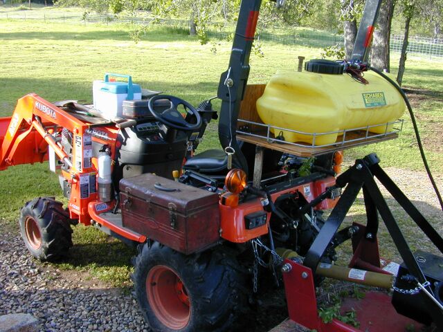

Well, maybe try searching for BX + tool ... who knows /forums/images/graemlins/wink.gif
While you're searching ... I have: the saddle toolbox on the left rear fender, the mono-bolt-cowl toolbox above the gauges, the ROPS-area-hinged flatbed carrier, and the over-the-hood hinged 20"x30" catch-all storage area. I think about all you've missed on this thread is the excellent, cheap, easy, canvas ladder-caddy that lays perfectly over the back of the seat.
Cheers!
PS, if you figger out a way to get that cruise control, you've got to clue us in!!!
Cheers!
