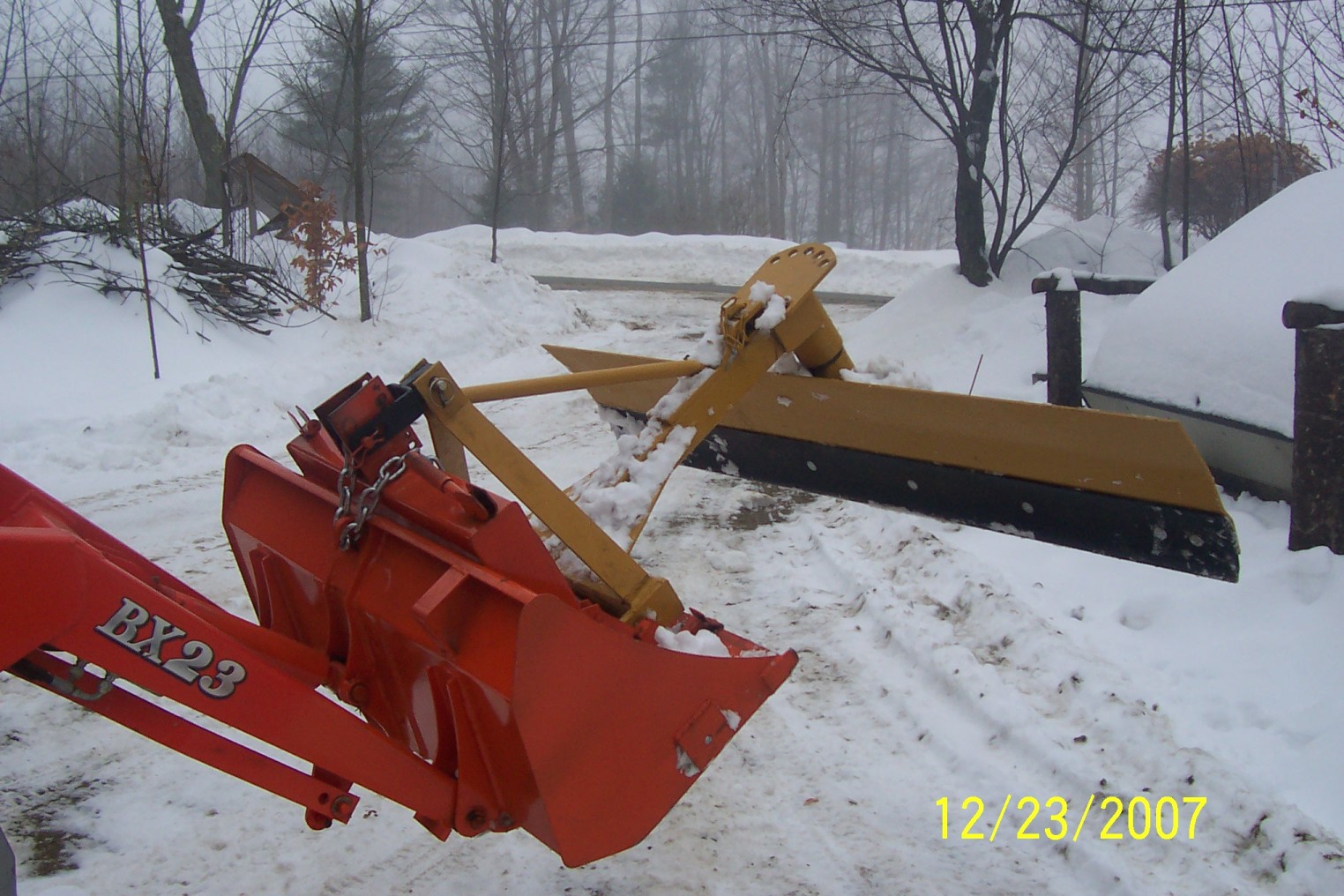

I got this blade i bought at TSC.Its nice and tall for deep snow.It angles easy,and is really rugged,might be a nice counter balance for your blower also_Of course in this pic its in my bucket[because i have a rear blower]but ive used it behind the tractor,and it worked well.Its a 6 footer.You want it to clear your wheels ,when its angled,4 foot isnt enough for that,6 is. If i had it to do over,id still buy the same blade,I push it backwards to plow,pull it to scrape ,and its heavy enough to break up tough ice the bucket wont,and scrape clean.

Have the Woods RB60 -five foot - on my BX24. I got it because I wanted the tilt feature, but haven't even used it thus far. Otherwise I love it - good weight, just got my first snow time this week and was perfect. Have done 20-30 hours of grading dirt, realized I had no skill, so got the skid shoes - well worth it.
I would probably not go less than 5'. Six sounds good, but not sure I could swing the blade around without hitting the rear tires

Very Good point,dont know if the 6 ft will swing around .Istill think most push snow with the blade backwards,less aggressive,and easier on 3 point.Aggressive scraping most will pull the blade,which is what the 3 point is designed for .Been some posts on here about people damaging stuff pushing snow,so i think id like the blade backward so it dont dig in so much.Iguess if you are on tar it might be different
