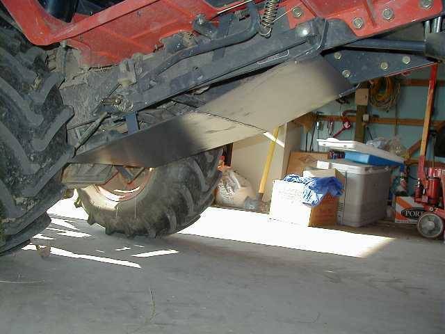

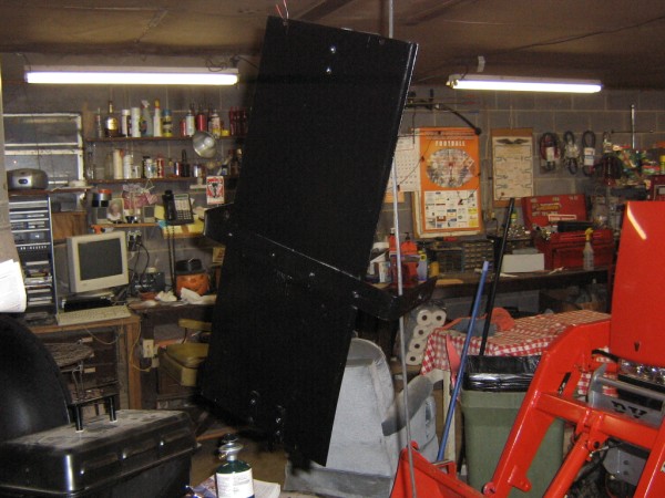

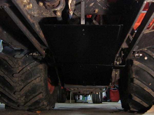

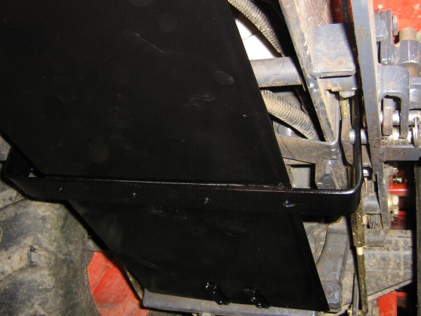

Well I decided to add alittle more protection so broke down and fab'ed up a cheap skidplate today. I had enough stock laying around including an access panel off of a PBX cabinet so alittle pounding, pending, drilling and bolting I hopefully have alittle more protection for all the grubbing I'm still pondering on doing :D :D
The rear brackets slide over the frame just below the HST and the front brackets hook into the MMM lift arm mounts. A spacer in the front keeps it from slapping arpound and tightens it up. Theres still gaps on the sides but it'll deflect anything direftly below it :D

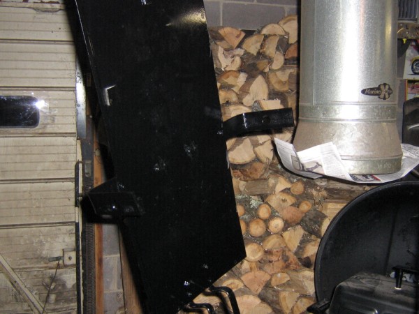

   / BX23 hydro fan busted. #7
Volfandt said:
Well I decided to add alittle more protection so broke down and fab'ed up a cheap skidplate today. :D
I like your skidplate, looks easy to put on and off. I'd like to see how it hooks on the back, I've been thinking about making mine a little longer, mine hooks in front and I like that if it hooked or butted up in the back, I could take the hooks off and let it hang from the mower lift arms like yours.

   / BX23 hydro fan busted. #8
Milkman, your skidplate was one of the ones I used as a template.
In the 1st pic you can see the two hooks at the bottom of the plate. I cut 2 pieces of 3/4" wide x 1/4" thick bar stock I had into 7" pieces then heated and bent them into a "Z" shape. They slide in on top of the frame just below the HST.
I like your version also. While mine is very easy on/off, yours is much more stout than mine :D
