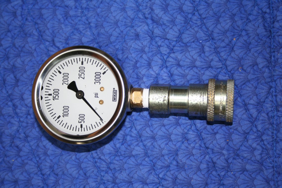

I would agree with radioman. Check the threads for setting the releif pressure. I checked mine a while back and found it to be about 250 pounds low of the recogmended 1850 PSI.
I made a very simple test fixture to do the measurement. The glycerin filled pressure gauge was purchaced thru Grainger for about $16. I had a spare quick-disconnect lying around. I disconnected the top front loader quick-disconnect and put the gauge in its place. Pull back on the loader stick and hold until the gauge tops out. Make sure that the tractor is warmed up before testing the pressure. After taking the reading, push the loader stick forward to releive the pressure, and remove the test gauge.
The adjustment of the releif pressure is about a ten minute process. It requires removing the left rear tire to get the releif valve. Shims under the spring adjust the pressure. My valve had two 0.4mm shims and it took another 0.4mm shim to bring the pressure up to the specification.
