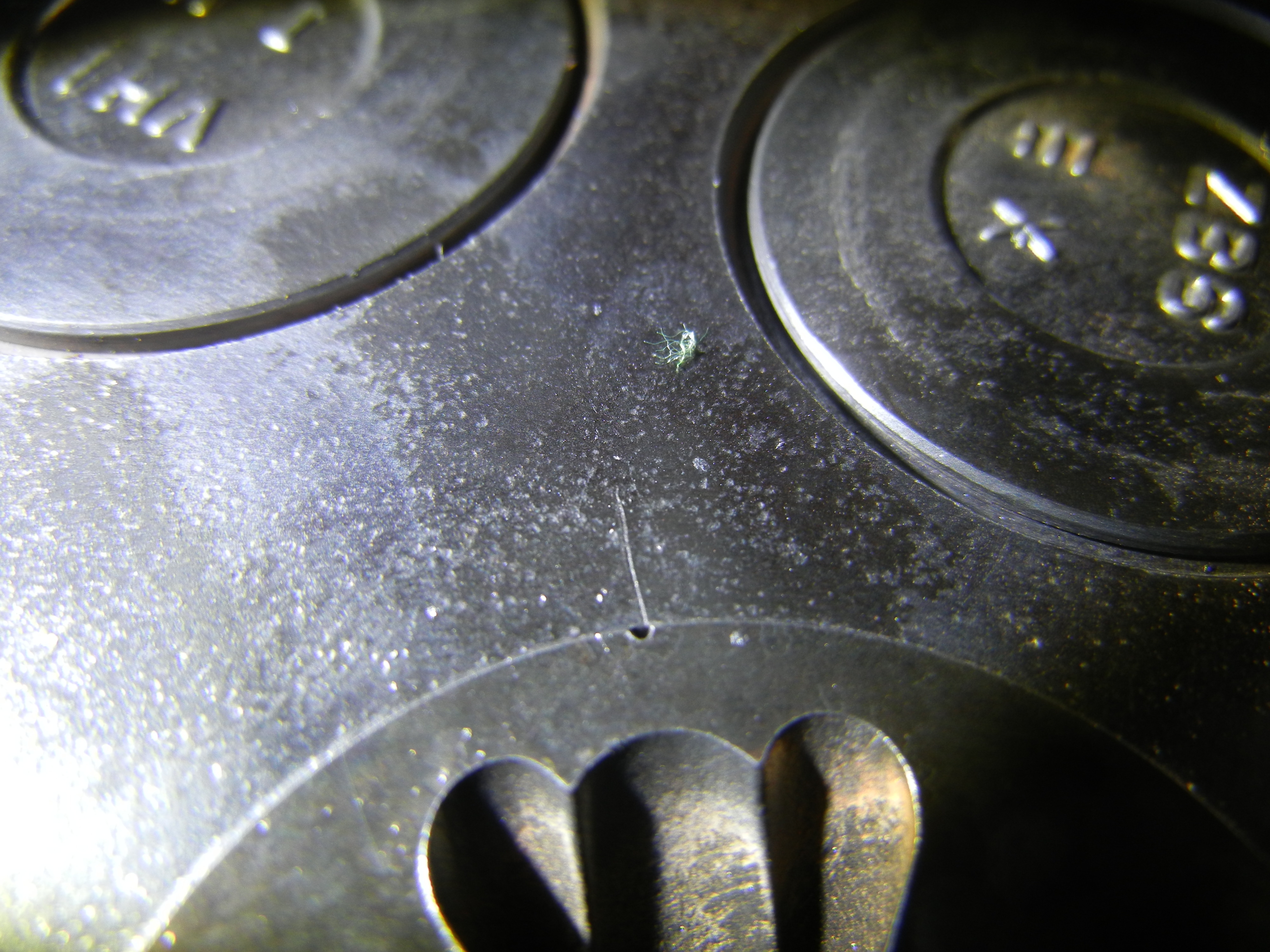

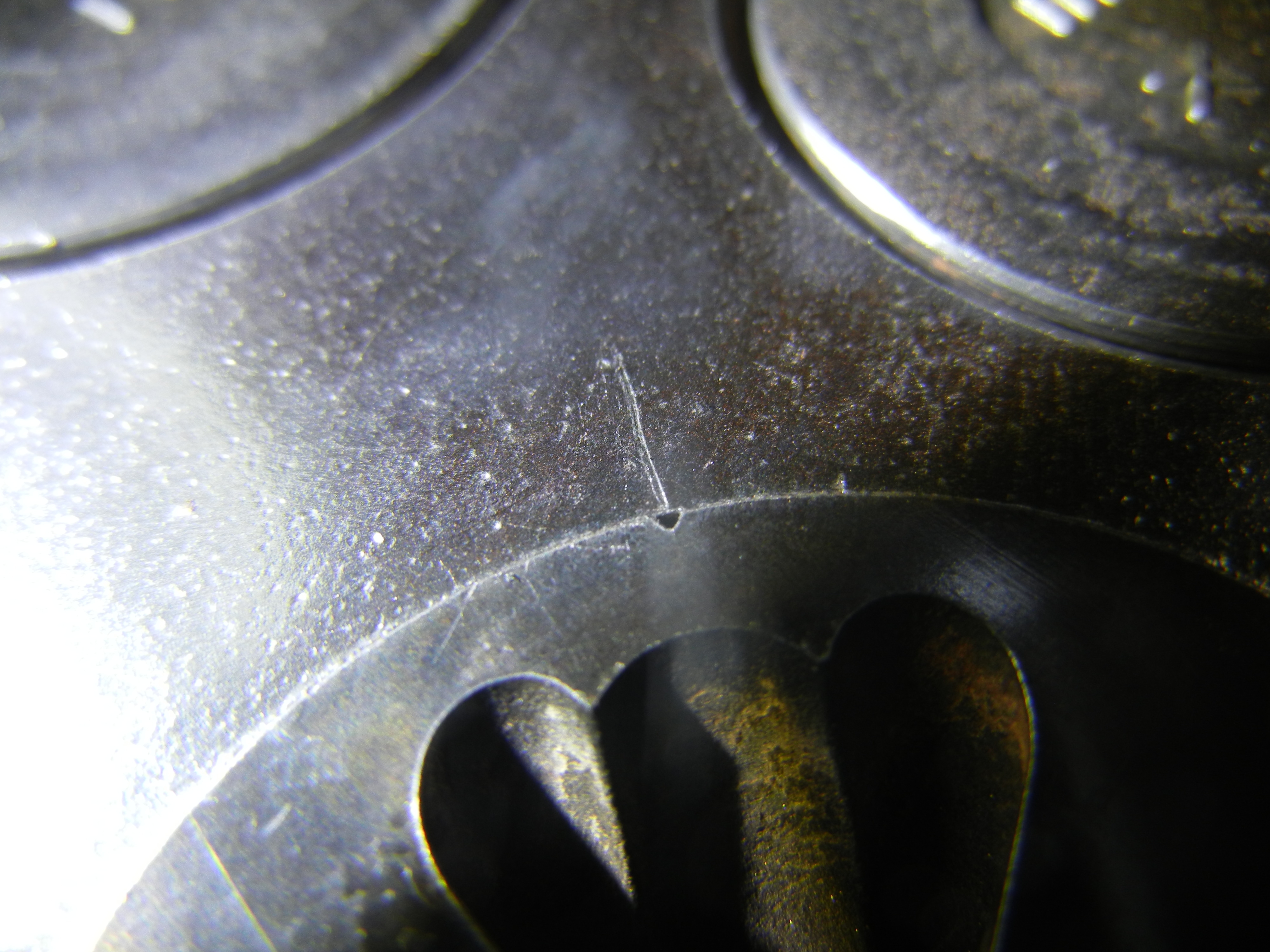

Here are 3 pics of my 3 different combustion areas.
Each seems to have....
A same size line, then a stake point, middle
flute of precombustion chamber?
OR
exactly the same crack.
Assuming these are assembly marks, what is a good homebrew/DIY crack detection method?
Or, not finding any, do I just assume it was the gasket?
I had oh-so-slight bubbling in radiator, 22 years old.
   / BX23 head DIYer, machinists?
I suspect it's to align the circular insert that closes the pre chamber. They all curve off a bit at the top - as though the guy was aligning his scribe, and pulled it down against a 'jig' - straighter at the bottom.
The inserts all sit proud a bit - how would one surface the deck?
