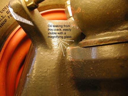

This is very interesting - there have been a number of people on TBN saying they had leaks in the front axles of the BX tractrors. I had leak similar to the one you are describing in my BX23 and my dealer found the same problem - a hairline crack in the bevel housing on one side. My dealer replaced it all under warranty and the problem has not re-occurred. He also said that there were no instances of this happening on the Kubota tech references and the Kubota rep had not heard of this happening before.
Your dealer should make sure that he reports this to Kubota - my suspicion when this happened to my tractor was that there were more instances of this out there that were not getting reported - no offense meant here but I get the impression that a lot of tractor dealers aren't what you would call top flight mechanics. Your report of a cracked housing on your BX23 is a confirmation of this. The more people report this problem to Kubota the better off the next person who has a leak in their BX axle will be.

I had the crack problem on my BX1500 as well. Dealer replaced the seal twice, then I took a good look with a strong light and saw the crack - see attached picture. This is apparently not an isolated problem.
