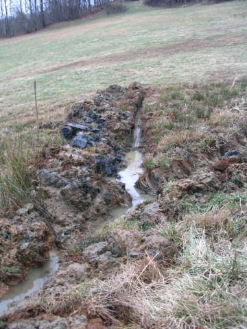

I've only put 50 hours on my BX23 but from what I can tell the FEL bucket it comes with is about as big as it will handle. I'm sure its designed that way for the users safety. The BX23 will suprise you though. Its the swiss army knife of tractors for sure. Lots of low end grunt to spin all four knobby tires on any surface. The backhoe is the reason I bought mine and so far its worked perfect for my project. I'm digging on very mucky clay and the BX23 is light enough with its fat tires to keep me on top. I've already solved some major drainage problems in the 50 hours i've had mine. /forums/images/graemlins/grin.gif
