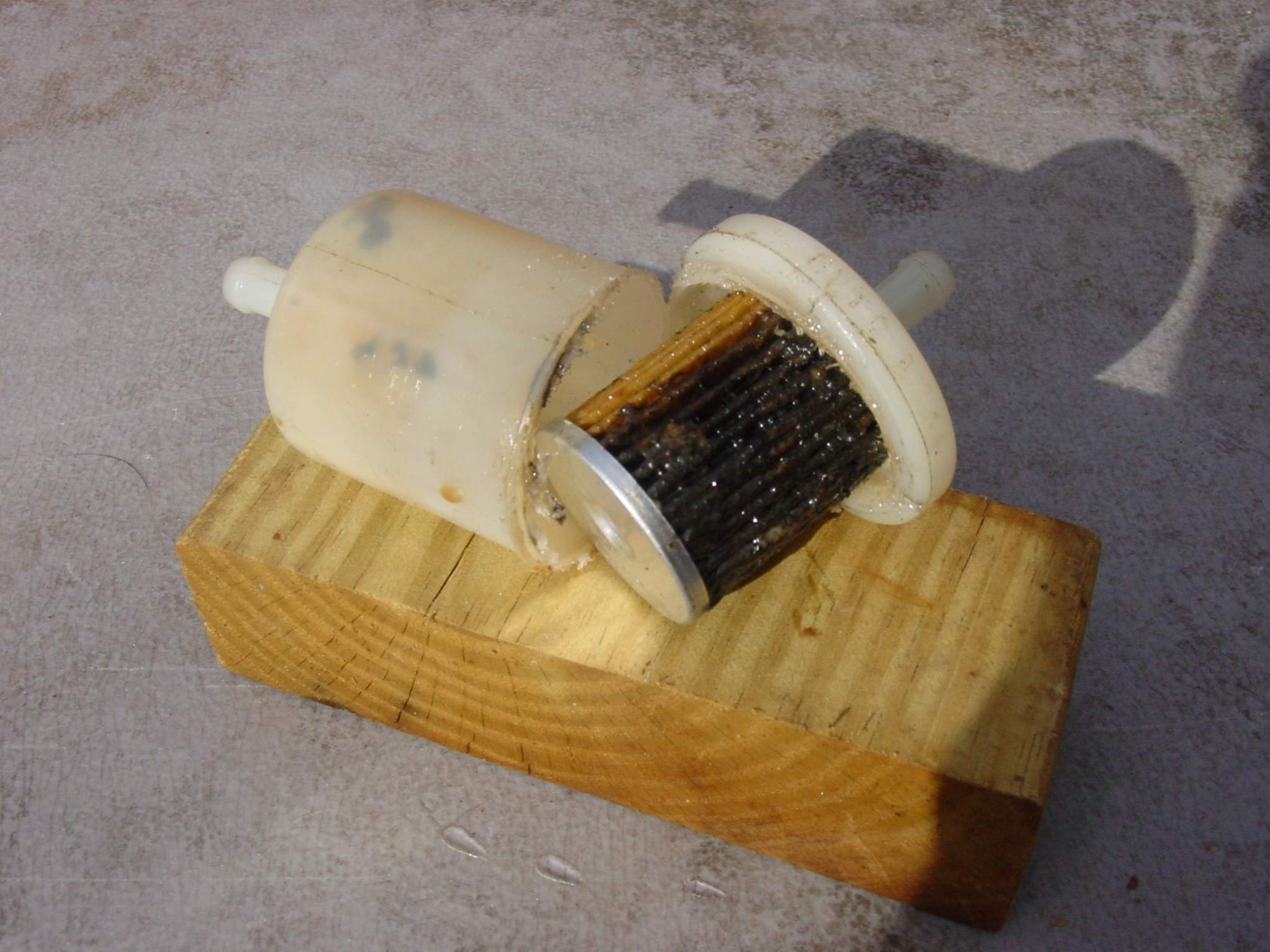

Hello,
Haven't been here in a while. My BX23 has been acting up lately with it idle, doesn't matter if it's cold or fully warm up. Yesterday, after completed the snow throwing job, I went and put the BX back down in idle but the engine started to choke and die, had to re-start but will die unless I increased the throttle up right away. I'm going to replace the fuel filter today and see if this help. Any suggestions besides fuel filter?

Check the air cleaner, make sure it clean and some family of mice didn't decide to build a nest in there. With mine, when the fuel filter starts to clog, it idles fine, but won't make good power. I would go ahead and change them, there are two.

Just finished replaced them filters and WOW! smooooth idle now, I can tell the engine purring now! :).
Here is my summary
The rear one under neath the floor is a piece of cake
The front left engine one is best to go from the left side of the engine cover, loosen the engine cover screws will give you better access.
Just get ready with some fuel line plugs because fuel will flow out once the filter has been removed. It's best to pinch the hose from upstream.
I'm happy that my idle issue was just the fuel filter.
BTW, the rear fuel filter was completely clogged :YIKES:

Thats the way mine will get, almost plugged. In my opinon, they are to small.
