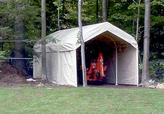

I bought this (see attachment) 10' X 20' canopy at Costco. A plow is stored in front of the BX23 and next to the plow I built a small platform that stores some fuel, the 3pt hitch and misc stuff. Tie rapped a small piece of peg board on the supports for a bit more storage. It is anchored at the corners with either some chain to concrete or to a tree. The legs each are secured to the ground with 10" galv. spikes(Home Depot). There is a door that I keep rolled up, it is a zippered door, but the ROPs won't fit under it. I don't know if Costco sells them regularly, but the one in by me sold them for $150, which I thought was a pretty good price.

thanks for the reply it looks a little long for the length but if they make them smaller length wise it might work out i dont have any other attachments to put in with it but im sure something will sooner or later. maybe a 8x14 or 16. . .jim
