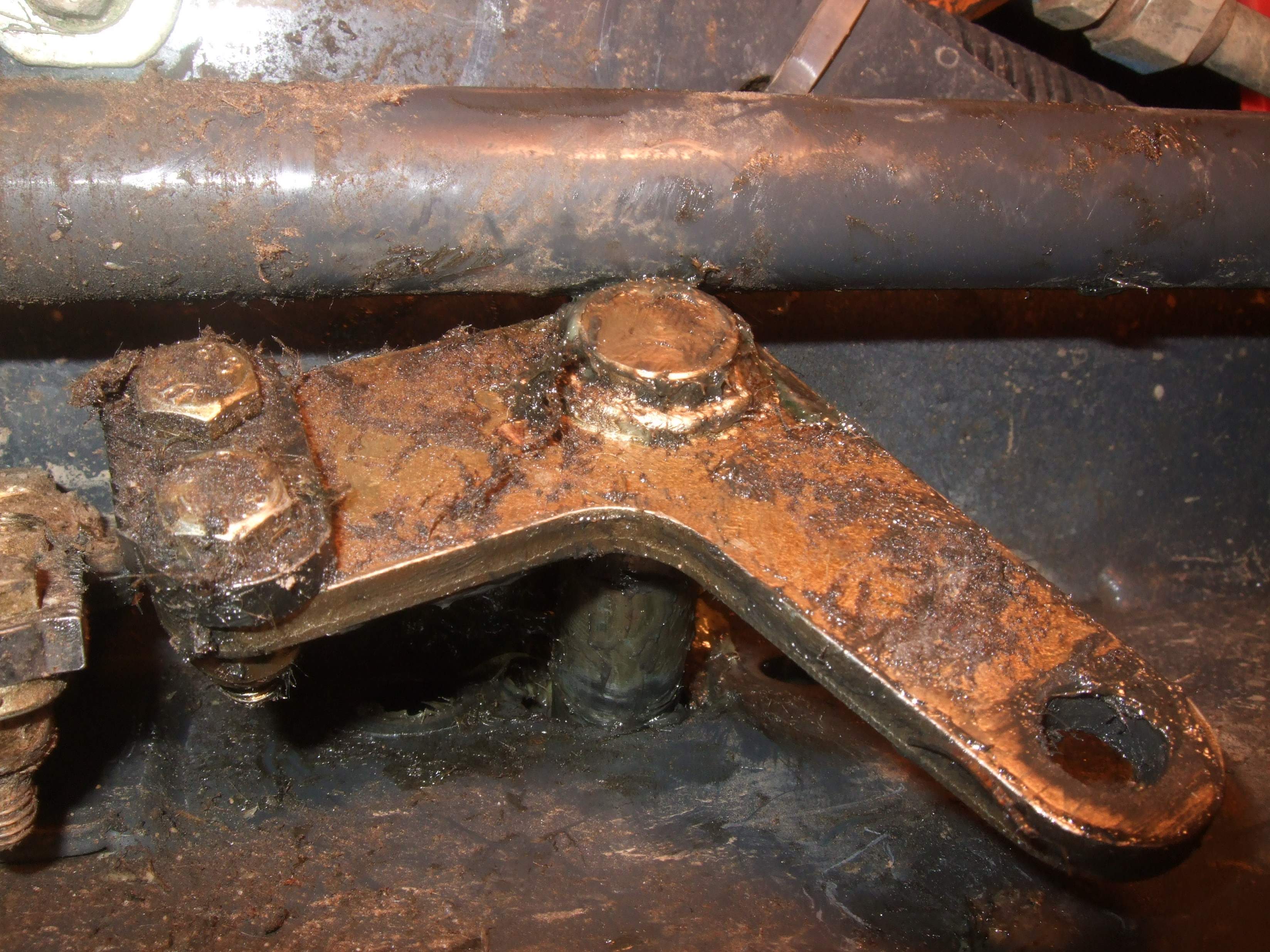

Have you tried to see if you can get a kit for it ? When I last looked how mine is setup, it looks pretty much straightforward.
I apoligize for the messy picture, but if you look closely on the left side of the picture, you will see the teeth part on the HST linkage. That is the cruise control holder.It is partailly disconnected on my BX when I worked on it last. If you have those 2 holes available on the linkages, then it gotta be easy to install one like from BX24.

Bryan, Your tractor -BX23, is based off the same series as the BX2230. I would look there.

I don't know anything about a "seat belt slot"...if you don't have an open slot for the cruise control, I'd be confused. I'm guessing you have an 'earlier' BX23...as far as I know my BX2230 came standard with the cruise control, so I would have assumed yours to be the same way.
I've uploaded the two sheets from the parts manual that have the mechanism parted out. I would think this to be available as a kit, also. Either way, your dealer should be able to get it for you and it should install in your tractor easy enough.

I was unable to find the sales ticket for the cruise control, so don't have a clue what I paid for it. The kit, #BX7340, is not really hard to install, just takes a little time. The instructions I have are in color, but I don't remember if I downloaded them or they came with the kit. The instructions refer to the kit fitting BX1500, BX1800, & BX2200 tractors. It went on the BX23 with out a hitch.
