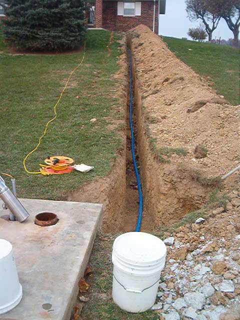

This is how I spent my fall vacation the week before Thanksgiving.
My parents were taking out the old above ground jet pump and well house and putting in a submersible pump. It was way overdue, you should have heard the noise that old pump made. Dad said he was going to just rent a trencher but heck this is half the reason I bought my BX in the first place, to help them out on stuff like this, so I borrow the neighbors trailer and take the BX to the farm.
Now I have dug a few short trenches around my place but nothing over about 10 feet long. We have had a VERY dry summer around here and their soil has a high clay content. At my place I can dig ten feet in about 20 minutes or less so I figured maybe a day to dig the whole thing. Wrong!! It took a good 4 hours just to dig the ends then probably another eight to dig the trench between them. This is by far the hardest I have ever worked the tractor. I couldn't use the scrape method to fill the bucket it would either just skip right over the top or it wouldn't pull it through. What I ended up doing was, if I can explain it, dig the teeth in, curl, uncurl while moving the boom and dipper back, and curl some more. The clay came out like gravel and just as hard. All I could think of was the old timers having to dig this kind of stuff by hand. When I got done digging I asked my uncle how they would have done it back then he said "wait till spring when the ground is softer" Anyway this is the first relatively big backhoe project I have done and it turned out pretty well. I didn't take many pictures but in this one you can see the blue water pipe. The electric line is already in the trench with some dirt on it
Dad:
"to keep it separated from the water line, I don't want the wire rubbing on the water line"
Me:
"but it won't be moving enough to rub"
Dad:
"if we do it right this time you won't have to replace it in 30 years"
Ok so you got a point there.
Can't argue with him, his stuff never breaks.

Thats a nice straight line. You know, things just seem to work better when the work looks good :D
   / BX23 and my fall vacation #5
Very nice! Looks like a pro dug that trench.
   / BX23 and my fall vacation #6
Nice work, Bernie. :)
Was that done with a standard 12" bucket?
How deep did you have to go?
I'll have a similar project here next year for 2 new water lines (from 2 wells) plus new electric, but it will be over 500', so I'm not sure I'll have enough time to do it all myself.

Wow thanks for all the compliments.
It was 36 inches deep by about 95 feet long.
The bucket is a 10 inch bucket.
Dad wanted about 32 inches but when I set the bucket teeth down in the trench it was 36 inches to the bottom of one of the hydraulic line loops so it was easy to check depth with that.

Don't know how deep the water would penetrate, but maybe next time, run a soaker hose along the path you plan to dig. I have softened up some holes overnight before digging. A steady saturation over a day or too might do the trick...
