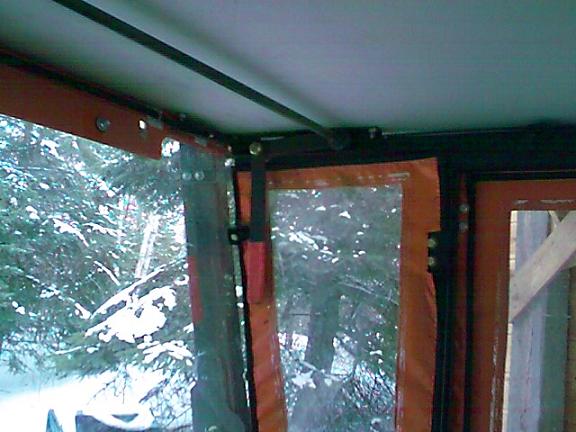

Yes "Mr. Junk"you can put a Curtis Cab on those BX, with a little modification. There a handle on each side to move the height up down.(2 position)

/ BX23 and Blizzard B54 #11
That is a great modification. Could you please post close up pictures of the mechanism and how it is hinged on the front, so I and others could make the same changes? Did you make this modification yourself or did the dealer do it for you? How much additional hight does it give you? thanks... Junk..
/ BX23 and Blizzard B54 #12
This work great...I've got 6" more clearence when I need it for the BH. Here is one photo showing the track on one side, the same design required on the other side.

/ BX23 and Blizzard B54 #16
did you do this or did your dealer? Where did the track and roller come from? How is it hinged in the front? A very good idea well thought out and executed. Thanks for the additional pictures..... Junk.
/ BX23 and Blizzard B54 #17
I would love to take full credit for this, but no. I've got the local Kubota dealer to build this for me (deal on the purchase). There is surprisingly not many parts involved in this. There is no hinges required for the front, it's moving from the front of the roof (flex, but no bends nor leaks). The track is just a steel channel & the roller from a motorcross chain roller. I love it.... go Kubota
