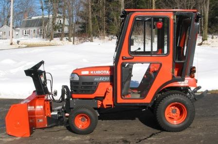

Hi Folks,
It has been a while since I have posted…thought I would share some pictures with you of my BX2230. I have had it since last March and so far I love it. This fall I added a Curtis hard side cab, hydraulic chute deflector and a Ford electric window motor for the chute rotator. I cannot take the credit for these inventions…the Electric motor idea came from a thread I read by Von over a year ago: Thread
The chute deflector came from Junkman Engineering : Thread
Thanks guys.
The Cab has all the comforts of home: heat, windshield wiper, defroster, circuit breaker lighted switches and my favorite…AM/FM CD Stereo.
I will post the series. Please wait with any responses until I complete the post. Note: I usually only check in on Friday nights so if you have any questions, I may not be able to respond until then.
Enjoy the post.
Steve

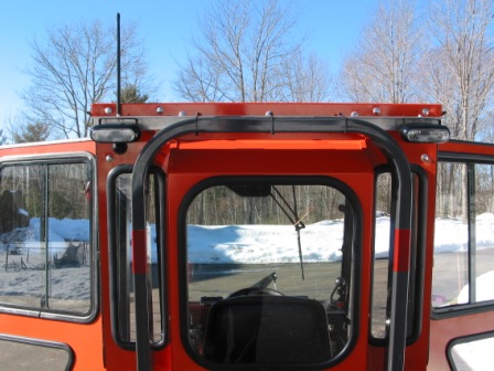

Cab pictures:
Front View: I need to keep my lights low due to the height of my garage.

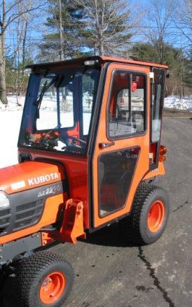

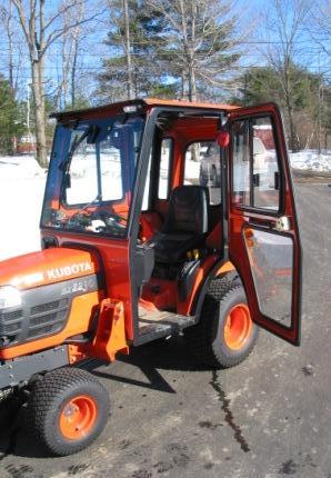

   / BX2230 with Curtis Cab and Snow blower: Let it sno
#2
Side View

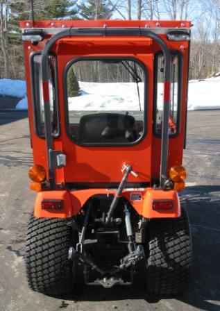

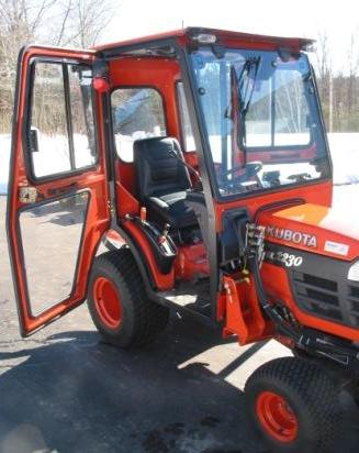

Rear View…
Note the rear work lights. Henro will be disappointed I did not drill my ROPS. I used aluminum angle iron from Home Depot. I used heavy duty Velcro and used heavy duty tywraps…doesn’t move. The lights front and rear are 35-watt flood lamps.

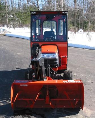

More outside views.

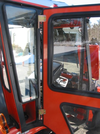

Disconnect the door piston and they just lift off these hinges.

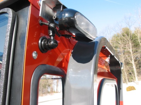

Close-up of the rear lights. Note the aluminum angle iron attached to the ROPS and the wiring entering into the cab via the rubber grommets
