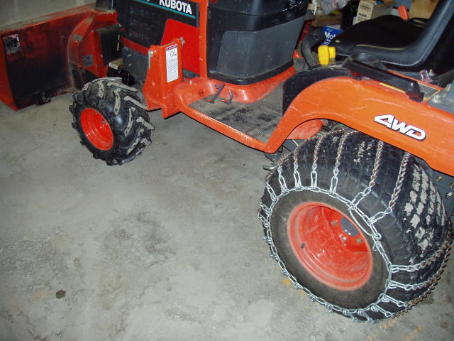

Unless something has changed very recently, the front bar and turf tires are the same size, as are the rears.
With turfs, you can run chains in the rear if you need maximum traction. You can also change out the fronts to bar tires and run them mixed- this is what I do for the winter and if I have plans to play in the soft stuff.
I have not found a reason to buy bars for the rear, given these options but I did buy the set for the front for $100 and my BX2200 will tackle almost anything now!!!
