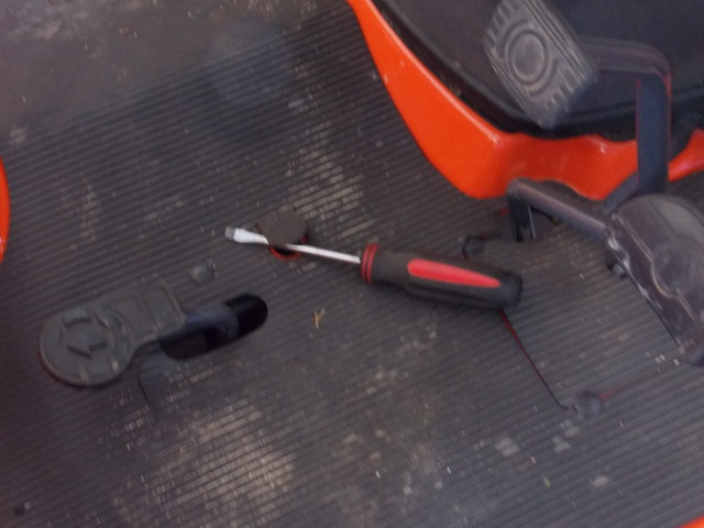

Regarding greasing, I don't know if your tractor has this zerk also to grease. I have one on my BX-25 under the floor mat.
This one needs to be greased every 50 hours.
