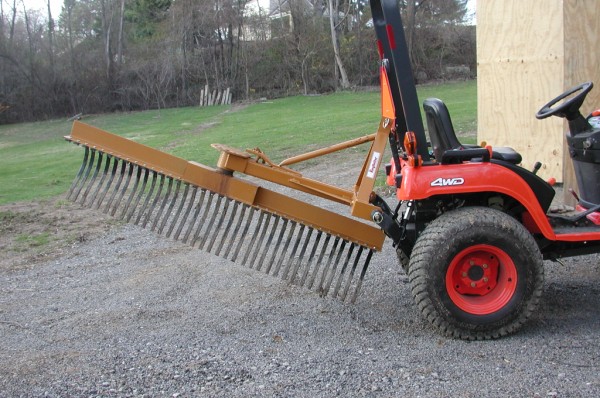

<font color="blue"> tractor supply has a king kutter 6ft for a fullsize tractor for $417. will my scut be able to left the bigger rake. thanks for your help </font>
Attached is a photo of a KK 6' rake on the back of my BX2200.
It would not swing around initially because the 3PH would not lift hige enough for the end of the rake to clear the ground. I made the simple modification of drilling two new holes in the lower clevis ends of the lift rods, about 1.25 inches higher than the standard holes, to get more lift.
As you can see in the photo, there is enough clearance to swing the rake around now, when the 3PH is full up.
I have four loaded bar tires on the BX now, but no loader. The rake works pretty well, but it is not too difficult to get hung up on something and find myself with wheels spinning and not moving.
But for easy tasks like smoothing dirt/gravel/crushed stone I am pretty satisfied with the 6' rake on the back of the BX. Especially if I have my gage wheels on...
There have been a couple threads in the past with photos showing how people here have made the modification to the lift rod ends that I mentioned. It is quite simple to do.
Hope this helps...
