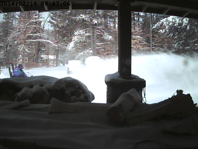

When I bought my snow blower off Craigs list, in the middle of the summer, the wife had her doubts. It sat in the garage for two years as the plow was adequate for the snow removal tasks. After last year, however, the snow blower proved its worth. I helped several neighbors that only had plows and had piled so much snow that they had no room left. The blower moves a lot of snow fast. If you don't have a cab invest in a ski jacket and ski pants makes the world of difference when the wind shifts and you get covered in snow :laughing:
2/14/14
