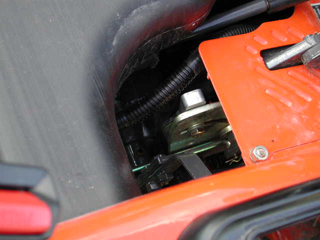

BX2200 won\'t stop rolliing forward/back. Picture
If your BX keeps drifitng forward or backward when you get off without putting it in neutral, Here is the fix. See the picture attached. lossen the bolt and move the silver arm forward or backward until the tractor stops and then lockup the bolt. I found this while settiing up my auto return to neutral on my 3-pt where you can see other pictures.
This is located under the seat.
