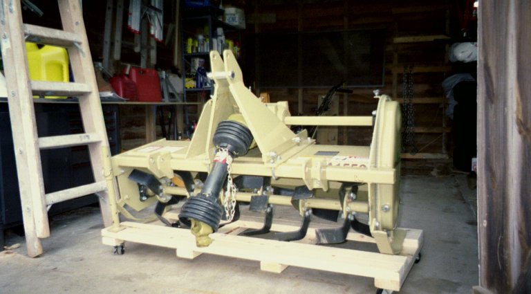

For attachments that aren't on caster wheels you can make carts/stands and that will help you maximize storage space. Here's a picture of a little stand I made for my tiller. If you look in the Attachments section you'll find some really good ideas for different types of stands and storage, made by some guys who actually know what they're doing/w3tcompact/icons/shocked.gif/w3tcompact/icons/smile.gif/w3tcompact/icons/smile.gif - unlike me.

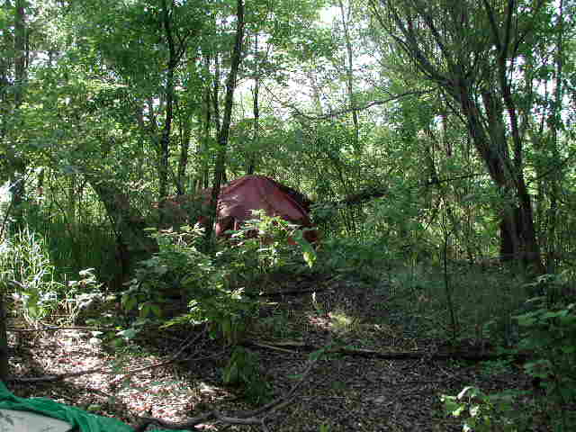

Now we begin the Project (See Pic)
Here it is, not the shed, the site. I live on 5.8 acres which is pie shaped 120 feet at the front and 900 on the river.
This location is about 300 feet from the house and hidden in the forest as you can see. I will start doing some clearing but not too much to start. It was 90+ today time to think not work.
As you have probably guessed, the red tarp is covering the snow blower.
I figure in the spring, summer and fall she'll be comfortable back there. In the winter, I let her hibernate in the heated garage between the wife's PT cruiser and my lowered Dakota Quad cab.
The next posting will be either the cleared site if it doesn't rain this week or scale drawings of the shop showing implement storage locations within so you guys can help out with comments. I am always short of change so you're two cents is always appreciated.
