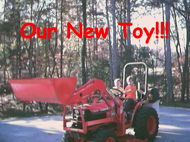

No, I have the hydrstatic drive model. I know it sounds odd and I haven't actually used the rear PTO so I can't verify this from my own experience. I have howevere read the manual no less than 10 times as this makes no sense to me. You gotta understand that when I was waiting for my tractor I thought I was getting a rear bagger just like the BX2200 which runs off of the rear PTO whereas mine actually runs off of one of the mower blade heads. So I was looking for a way to run the mower by itself. It's not possible. Not only that but you have to mechanically move a metal piece which for some reason prevents the PTO from going into second to run both PTO's at the same time. Then the Kubota manual tells you that you should put it back when you're done using it. It doesn't really cause me any trouble but I sure would like to understand why it was built this way.
