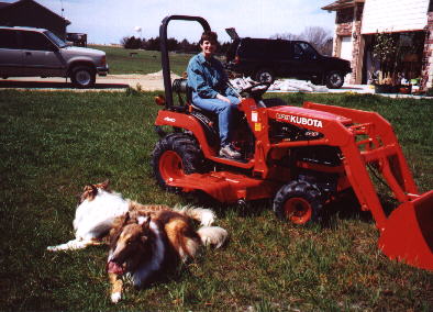

Rich you ask some good questions and several comparisons have been made on this site. I would and did get the BX over the 7500 for MY purposes. I need a tractor that is a good mower and has excellent stability, for this the wide low stance of the BX is an asset and coupled with it's clever packaging that produces a very compact manuverable machine for in tight mowing. The BX2200 has more horsepower than the 7500, weighs 1300 lbs stripped vs 1367 for the 7500--not much difference in size is there? The FEL is not as "powerful as the one available for the 7500 but it nonetheless works very well and will lift a full bucket of mulch, driveway gravel, soil etc. It will even dig into hard clay. My BX pulls the Kubota 48 inch box blade well, I am still learning to use it effectively. Anyway, the loader is an excellent unit. When I bought my boxblade the dealer used a forklift to put it in my truck, I used the FEL and a chain to do the same. The BX will need rear weight for maximum duty loader work--either wheel ballast or install a boxblade even better than ballast. The BX is my first "real" tractor but it is a fine unit. I looked at the B2400 also and could not justify it in addition to the fact it would not get in close on my beds and landscaping like the BX can. Here I do not have a lot of snow but we had a pretty good amount this year and the BX and FEL kept my driveway clear. I have the "baby" bar tires. They provide excellent traction and I have found that by slightly reducing pressure and removing the FEL for mowing they do not tear up the grass at all as long as I make sure to stay off the yard when it is wet. Not a tractor pulling expert here but I bet the BX has at least as much pulling power as the 7500 confirmed by the fact they are rated for essentially the same implements on the Kubota implement chart. It pulls the 48 inch box blade with a full box and teeth down. The wheels break loose sometimes but it keeps going. I guess my point is that the BX 2200 is not really a step down from the excellent 7500, just a side step or even for some uses a step up. Ground clearnace, the BX gives up to the 7500 but when I demoed the 7500 it felt tippy on my ground and the BX does not. If ground clearance is an issue for FEL work remove the mower deck. Still for in the "rough" use the 7500 has the edge and if FEL work is your primary concern the 7500 has the edge. If you want a slick little utility tractor that is an excellent mower, stable with it's wider lower stance and very powerful with an excellent and very useful FEL then the BX should be favored. For me manuverability was the winning point thus I stepped UP to the BX over the 7500. They are both excellent units--good luck with your decision. Attached, my wife on the Baby "bota with collies last Spring. J

Great looking picture..also a tad jealous of the spring green grass you have now. /w3tcompact/icons/wink.gif
