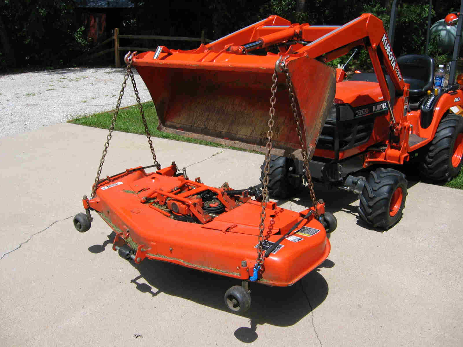

   / BX2200 MMM and blade use #7
well, I don't know, perhaps taking it off would help protect your $$ investment in the deck, IMHO.
This picture is how I make the change over easy as pie...
