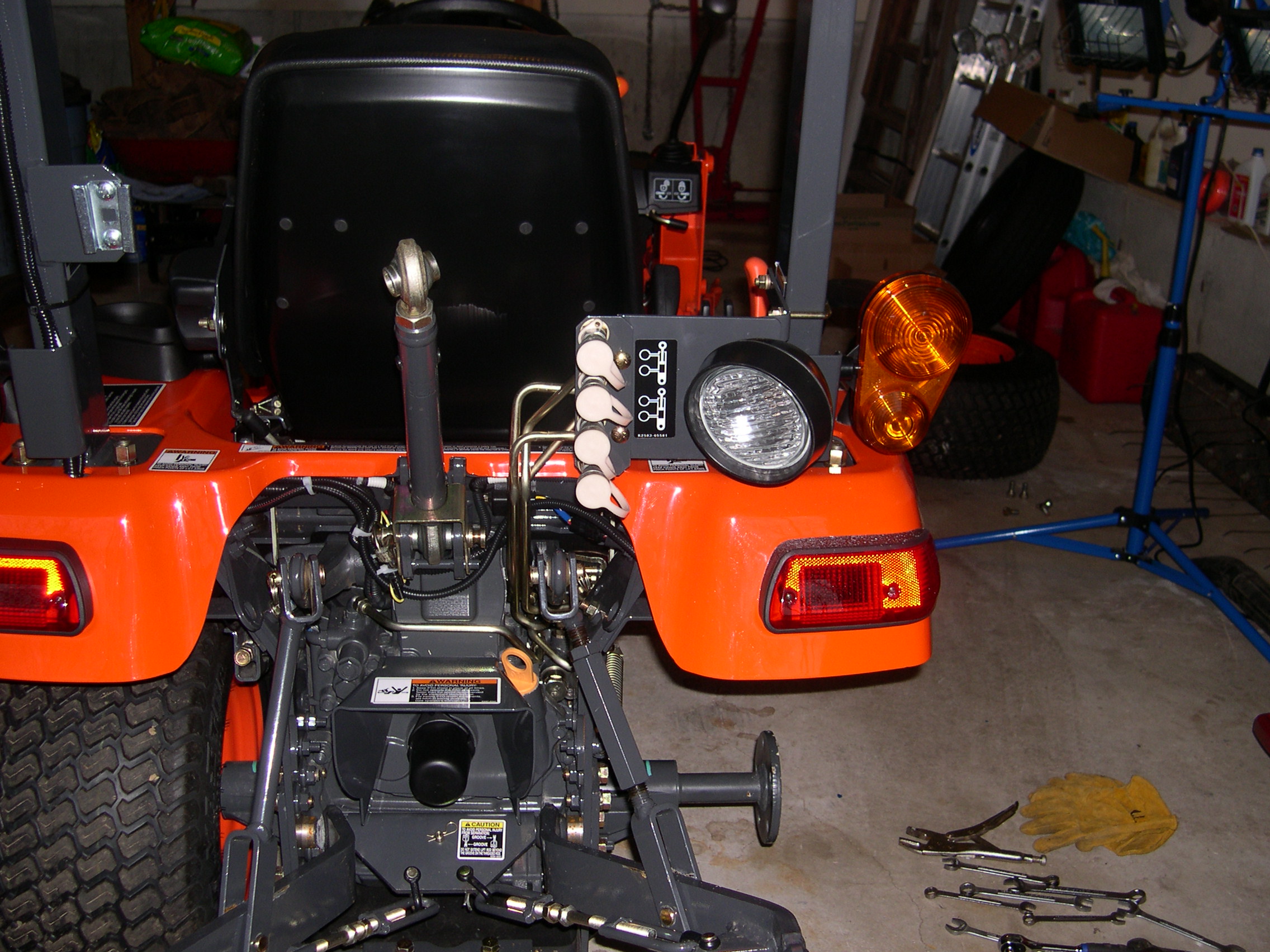

Builder, see if you have a threaded rod inside the left rear tire of your BX2200 - see pic of my 1860. The rod connects the 3PH to the MMM lift arms and can be adjusted to allow your MMM to raise up a little higher (as long as it's not hitting the stops on the underside of the frame). In many cases, the MMM doesn't lift high enough to allow for the height control knob to rotate to the "TOP" position. Your BX2200 should have this rod, but could be in a different location, like the other side of the frame.
See the nut at the top inside of my left tire. That is the end of the threaded knob. There's a keeper nut and an adjustment nut.

..... See the nut at the top inside of my left tire. That is the end of the threaded knob. There's a keeper nut and an adjustment nut.
Don't believe I've seen the back end of a tractor that clean, or shiny.

Yea. That was a while ago when new. She's all dusted up now from running my leaf vac. Nothing like dry leaves turned to powder to put a layer of dust/dirt everywhere.
