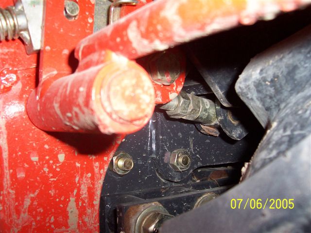

Just ran into another problem with the BH installation tonight. If the 3PH is all the way up, there is a threaded rod that can interfere with the upper latch on the right side. This rod kept the latch from snapping in place until I lowered the 3PH slightly.
