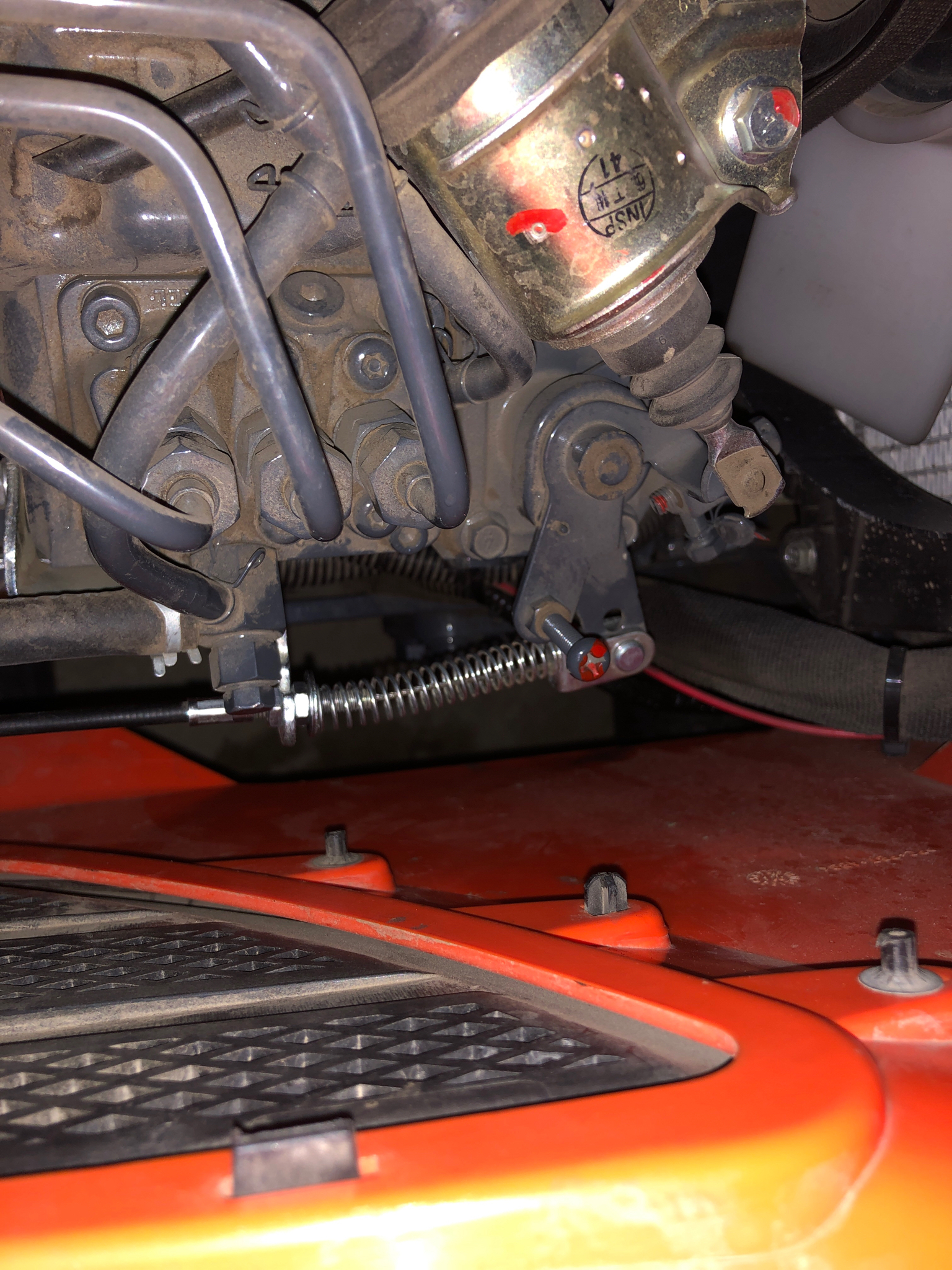

IMG_2556.JPG Check to make sure everything is in order on your throttle control cable (this picture is on the left side of engine bay if you are sitting on the seat). And take a video next time it happens to show your dealer. You are under warranty. Might as well take advantage of the warranty while you have it.

View attachment 595623 Check to make sure everything is in order on your throttle control cable (this picture is on the left side of engine bay if you are sitting on the seat). And take a video next time it happens to show your dealer. You are under warranty. Might as well take advantage of the warranty while you have it.
Checked that also, everything looks good. I had to slightly tighten the nut on the other end of the cable so it holds tension, but that was done quite a while ago and doesn't correspond to this.

I suspect your problem might have something to do with the lever with the red screw right above the throttle cable assembly in my picture. That’s the only thing that “clicks” once the tractor is off. And I just tried starting my BX with that lever engaged and it won’t turn over. Hopefully someone will come along and educate us both on what that assembly does...
So from what I've seen on the service manual, that is the fuel shutoff valve. When you turn the key off, that solenoid fires and closes, shutting down the fuel and the engine. (the click 10 seconds after shutdown is the solenoid letting go and letting the fuel valve open back up.) No matter what, that valve seems to be at the center of my problems.
Well at least we are getting somewhere! I’d pump out as much of that old fuel as you can, fill with new fuel and see if the problem disappears. Some good old #2 from the pump for new fuel. There is lots of debate over whether you should treat fuel in a BX. The manual says not to, so I don’t (at least not while I’m still under warranty). And grab a Mr. Funnel while your at it and only fill through that.
