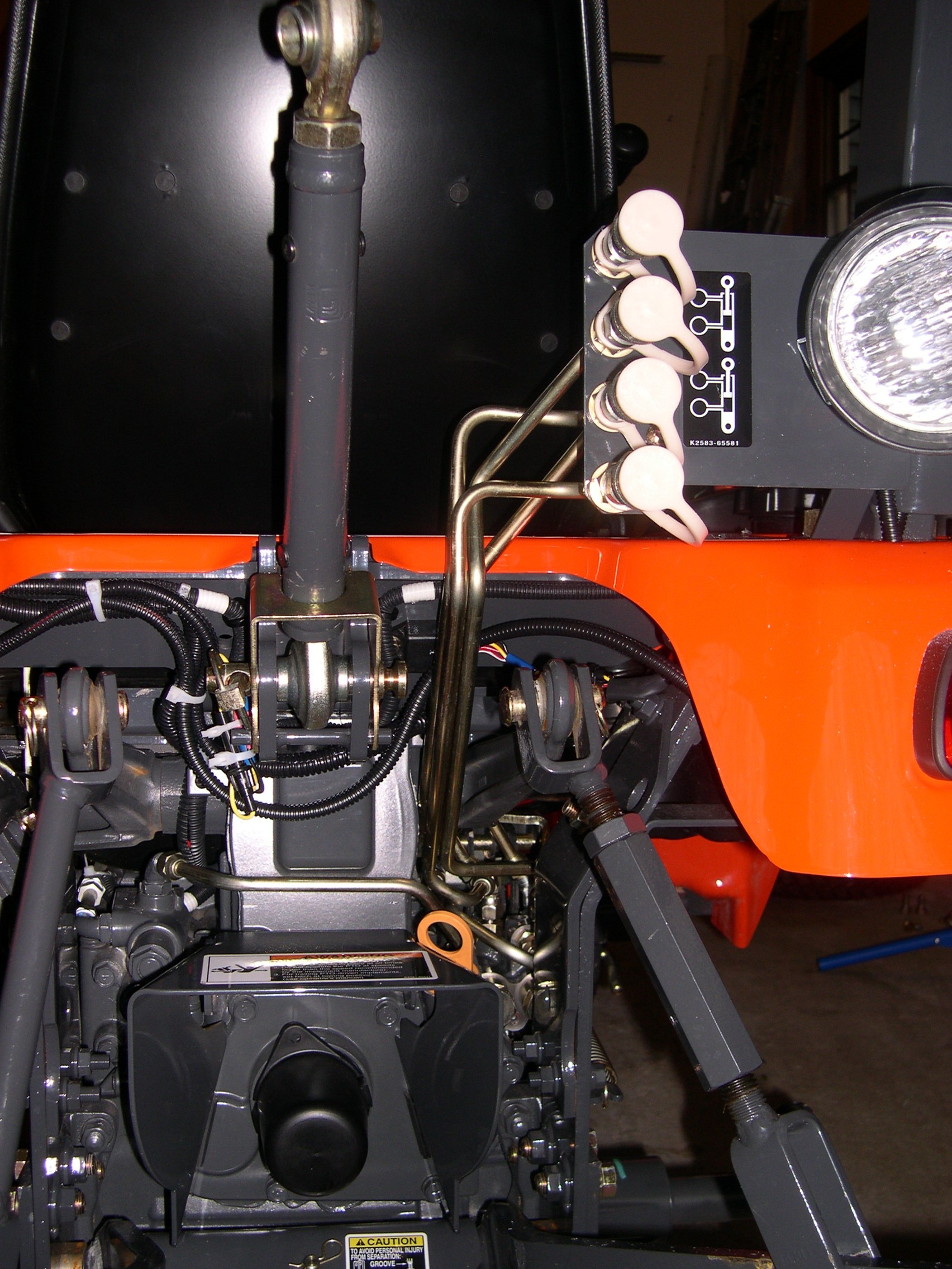

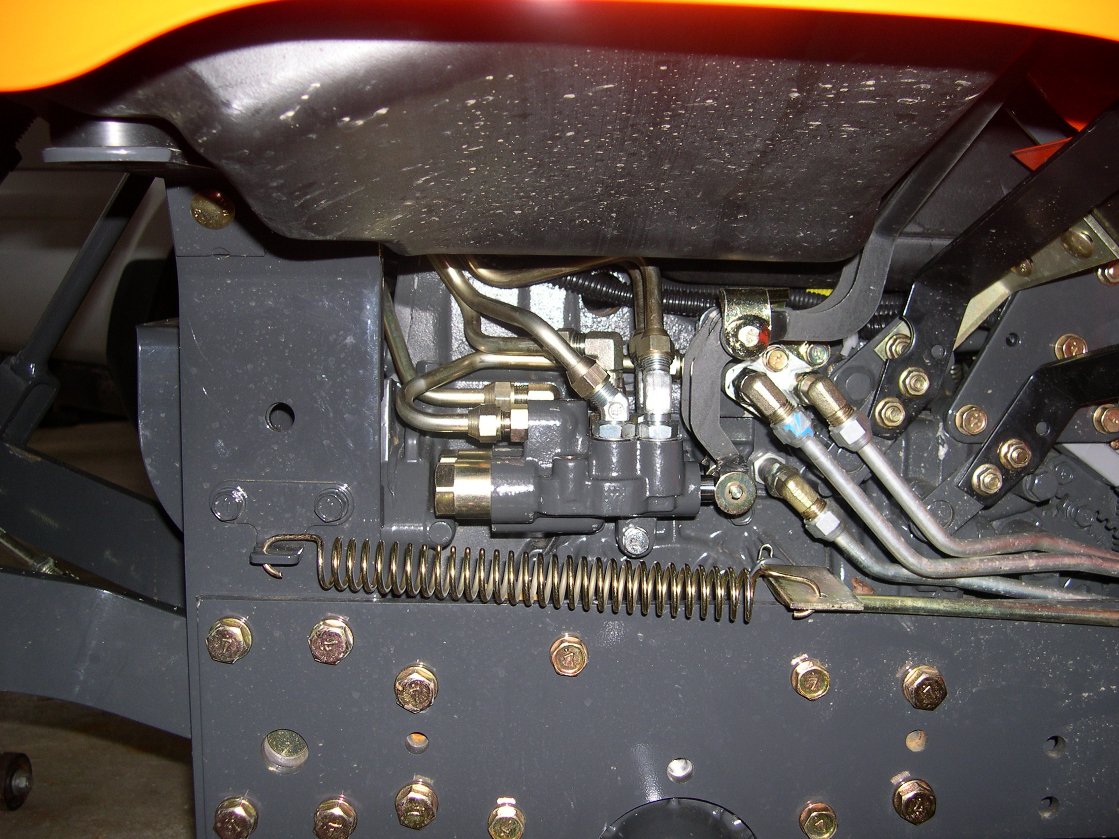

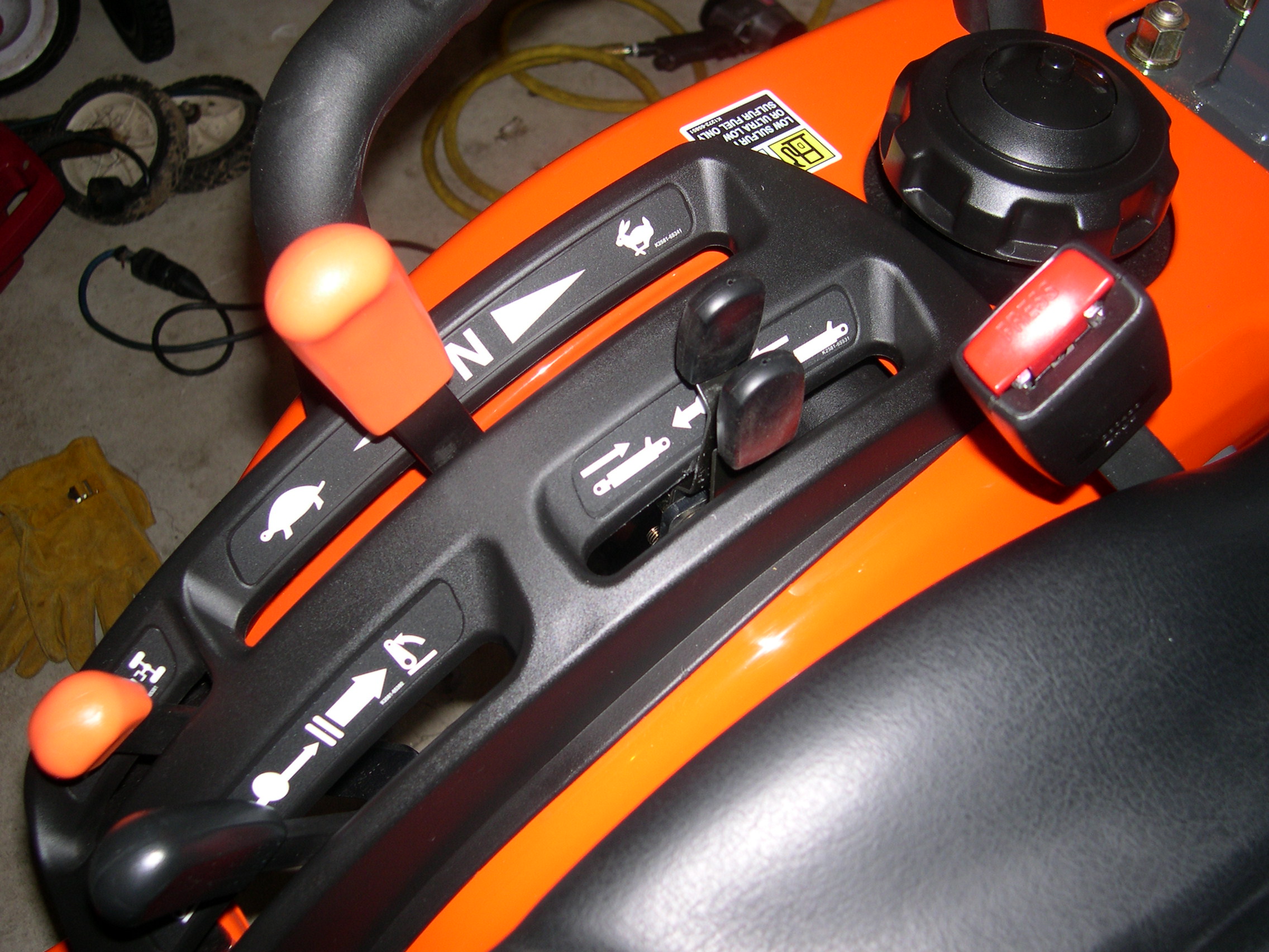

Kubota sells a dual spool kit for the newer BX series tractors - neat kit and very clean install and the price was reasonable. I added the kit to my old BX1860. I'd check with your dealer if there's a kit for your BX1800. It's a wholegoods item so you'd have to order it through sales and not parts. Here's a few pic's of my old BX1860 install. I think somewhere along the way, Kubota moved the hydraulic block from the left side to the right side (looking from the rear) of the tractor.

The kit was $320 ordered from Messicks a few years ago. I did the install, which wasn't bad if you remove the one rear tire. A little tight to swing wrenches in there, but it's doable. I didn't think that was a bad price for the valve, metal tubes, female QC's and linkages/levers. Doubt I could have saved much if anything putting a kit together myself and it sure wouldn't have looked as nice.

That was the first thing I did after adding the remotes, then I added a small 3PH wood splitter. Go for it. :thumbsup: (I miss my HTL - can't put this valve on the BX25 as it interferes with the backhoe subframe :( )
