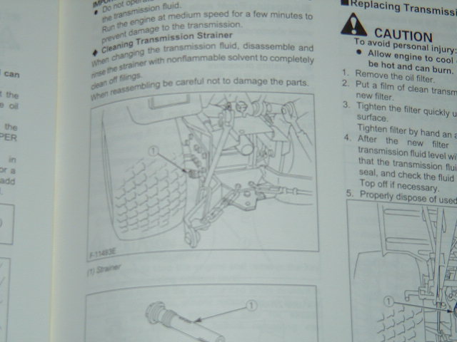

I purchased a demo BX1800 two weeks ago with about 55 hours on it. The dealer did no service to it so I asked them for the fluids/filters. They have not found the owners manual and have ordered one for me and I need to know where to clean the screen out when I change my fluid and filter.
Thanks
   / BX1800/BX2200 Filter change/screen? #2
I don't have a scanner, so I tried taking a picture with my camera and it turned out ok so here it is. The strainer is just below and behind the left rear axle as viewd from behind it and shown in this picture.

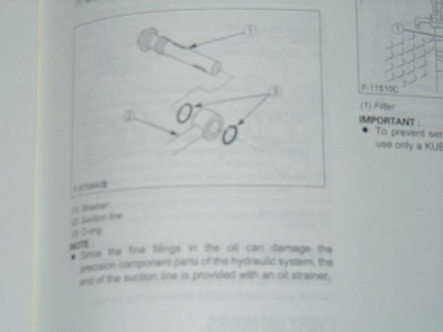

This one showing the strainer removed, didn't come out as well, but hopefully you can see it.

Thanks so much for this information.
