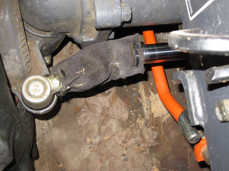

I have been reading this thread & not to hijack it but what I did for my BX24 when the boots got torn from brush, was I ordered two universal tie rod boots part #40193, also uses Massey part# 1885486M1. These boots sell for about $3 to $4 at most tractor supplies, online, & EBAY. TSC has these boots in a kit, but you have to buy 6 boots, 4 of which are not compatible & the kit is $20. Note these boots are not an exact replacement but the difference is so slight it is hard to see. They fit my BX24 perfectly & I was able to reuse the original metal retaining rings. Then so as not to have to do this again I used TECHMAN痴 idea of using a piece of 2 1/2in. nylon hydraulic hose covering held on with tie wraps to cover the boots. The nylon cover material can be purchased at any hydraulic hose place by the foot. Mine was about $8 for a 1 ft. piece. I used a heat gun to seal the ends to stop fraying & a soldering iron to punch holes for the tie wraps.

**Any shield** could pretty much eliminate the problem, even a bicycle inner tube over it. From the "HOW-TO" below you can see how easy it is to add a bicycle innertube over the existing boot. Electrical conduit would work too, but design that if it gets bent (jammed into the boot) that it doesn't rip the boot itself.
Here is a link to a HOW-TO for replacing torn tie-rod boots. It's a fairly easy job, the most difficult part is putting on the spring clamps without ripping the boot. Might be prudent to use zip-ties, and not pulled so tight, to allow the boot to slide off, (instead of rip) if it is being hassled by a stick. I think the spring clamps (if you don't rip the boot during installation) are detrimental to these boots. I sold my BX (with new boots) but if I was keeping it, i think I'd remove the spring clamps and replace with zipties, and not real tight.

My Redneck Boot Cover
