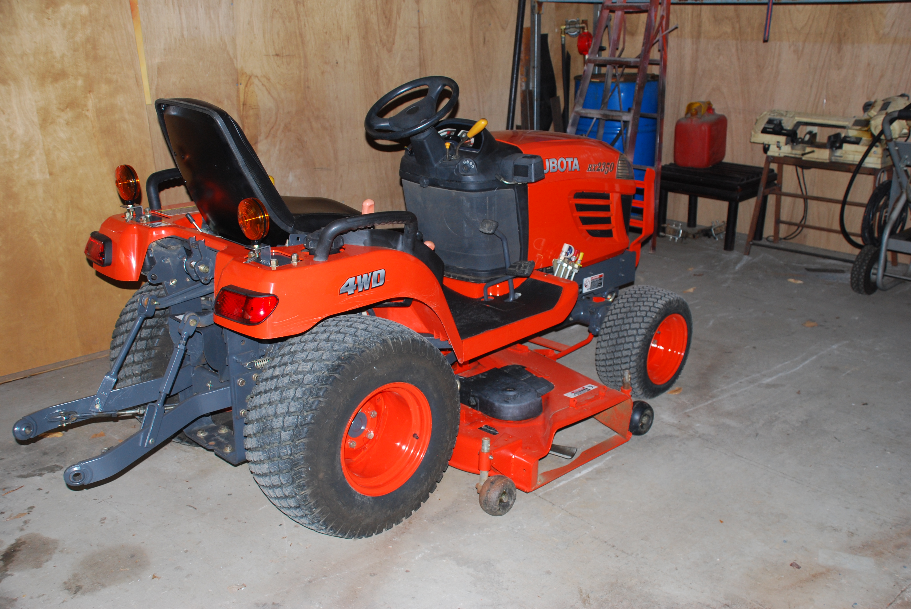

   / BX ROPS Engine/Transmission Noise? #4
took mine off
