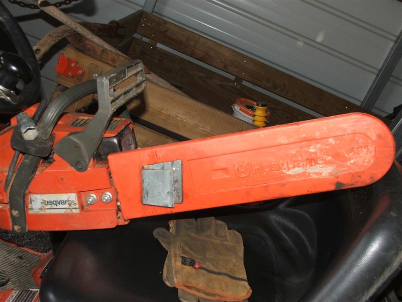

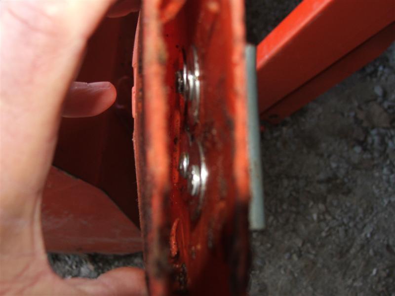

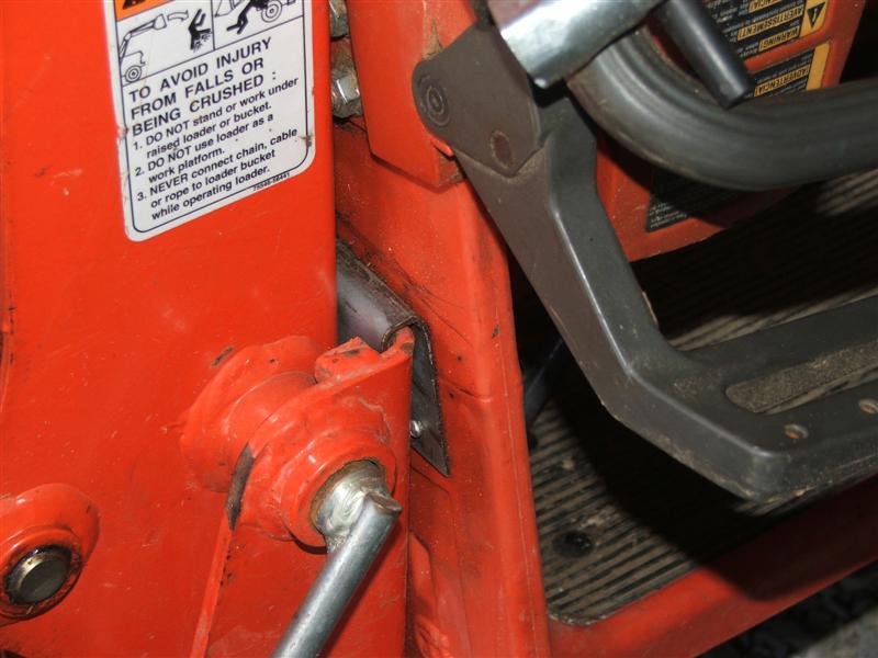

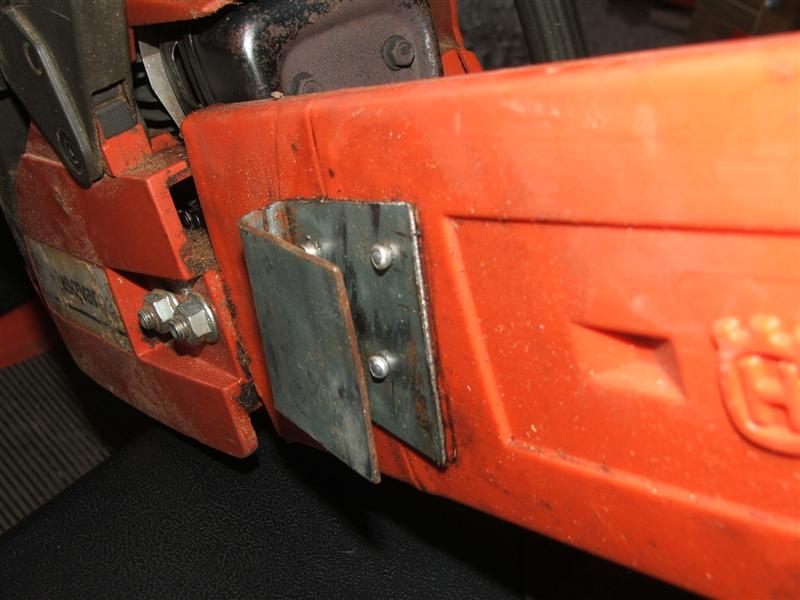

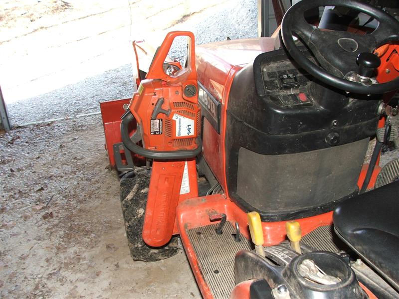

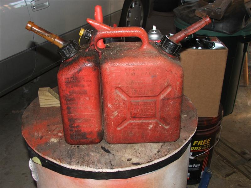

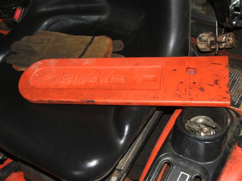

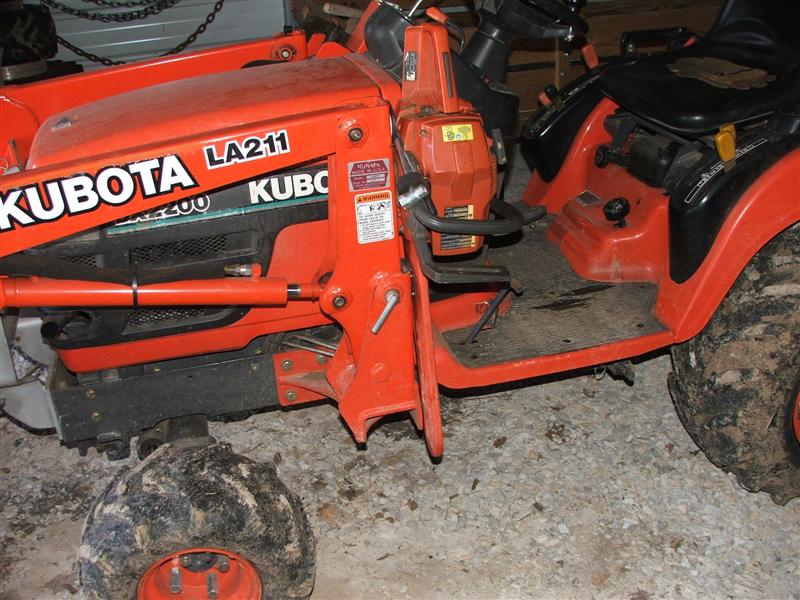

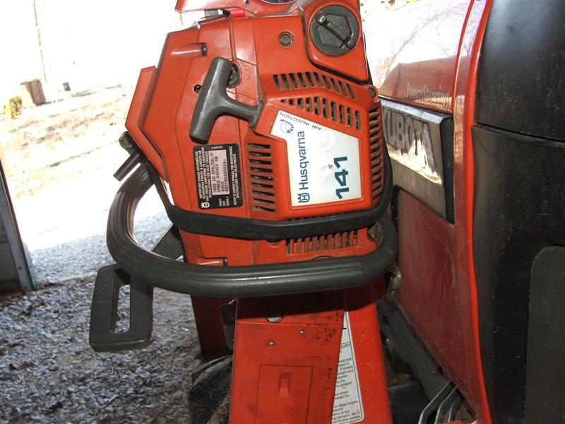

I've used this for quite a while, just went out in the cold and got pics since there's nothing else to do here tractor wise. I used a regular chain cover, bent a bracket and mounted it to the cover using steel pop rivets w/fender washers inside to keep from pulling the rivets through the plastic. I clip the bracket onto the loader mounting bracket and use a rubber cord to hold the saw steady. Now I need to find a good place to carry my gas/bar oil can.
