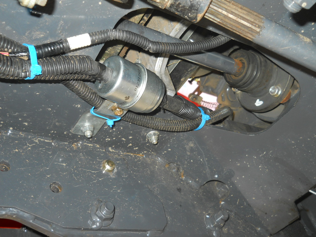

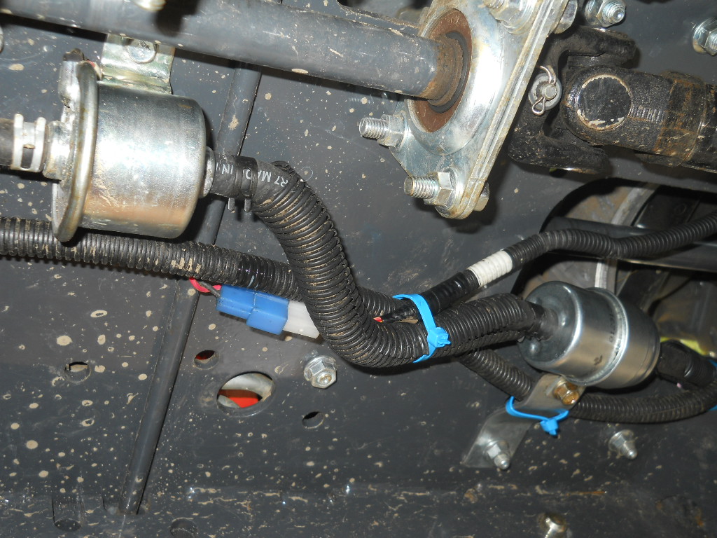

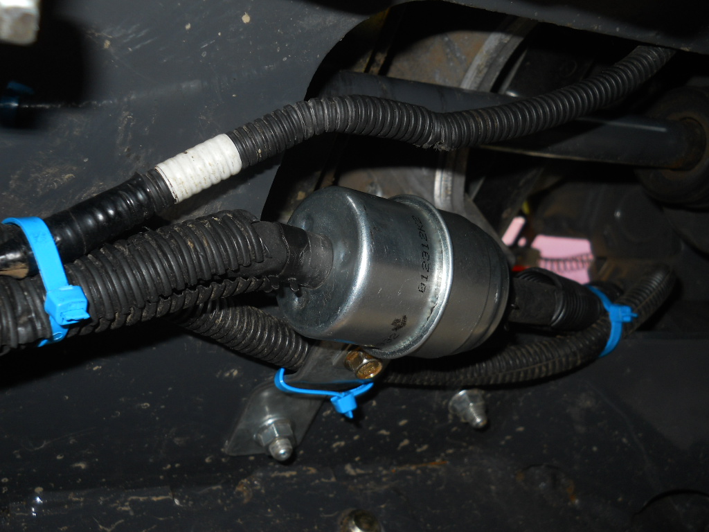

Here are pictures of my fuel filter relocation. Used the piece of hose from the injector pump to the filter as the piece between the booster pump and the filter and then the long piece from the after filter to the injector pump. No new hose required. Had to cut all the tie wraps and tape and replaced the tie wraps (I always have a bunch around). Made a small strap iron bracket to attach the filter to an existing bolt under there. The hose clamps by Kubota are a PITA as they are light weight. The new ones that come w/the NAPA filters are far superior and work well with a combo pliers to open up and move. Notice I use the NAPA metal housing filters instead of the plastic ones from KUBOTA. NAPA also has the plastic ones. I think the metal housings are more durable and less vulnerable working in brush and rough terrain.
