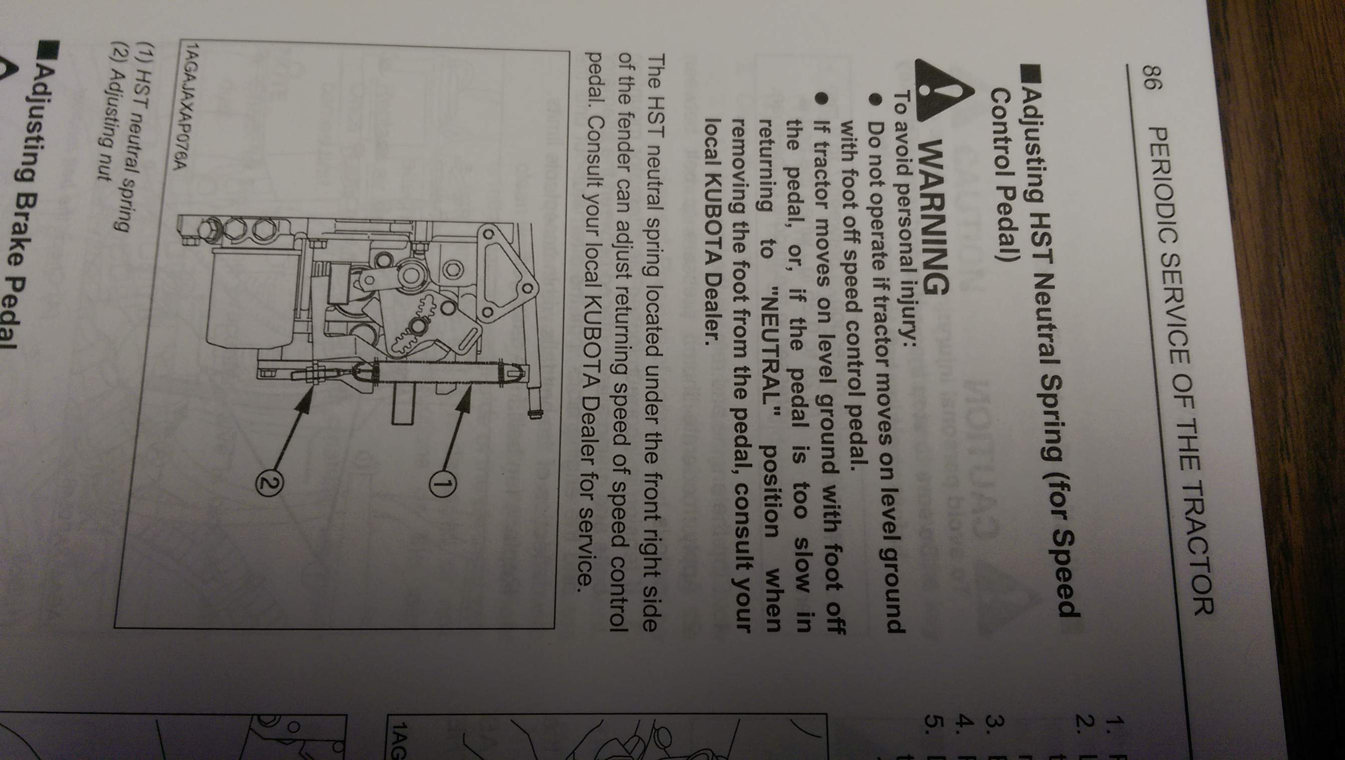

I took a minute to look at the BX25D owners manual. An excerpt recommending checking the HST centering as a part of ongoing maintenance is attached. Also referenced is adjustment of the control if it is too slow to return to neutral. I suspect there is a similar paragraph in the Massey manual.
Perhaps it's time for John to take a look at the Workshop Manual WITH the Master Mechanic to make sure the adjustment instructions are followed. If it still persists, perhaps it's time to look at the individual parts.
