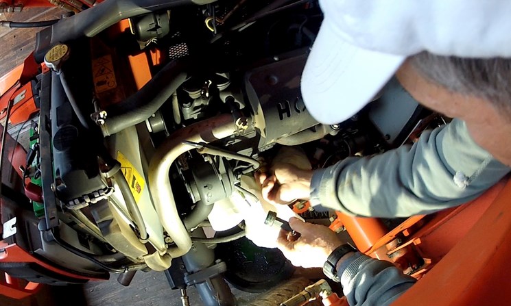

I'm not sure if the BX block has a threaded plug hole for the block heater like the B series, but if it does it's a simple job!
If it does all you need is a 17 mm Allen socket to remove the plug. I had the heater ready with Teflon tape and simply switched them, loosing maybe a 1/4 cup of fluid. Took all of 30 minutes to install.
Works well too. Started it up the other morning, 26 degrees and I plugged it in for 30 minutes. Started like it had been running all day!
Finished product...
Swapping as quick as I could...
The mechanic used a punch and hammer to take my plug out, a socket around the electrical connection to tap it in.
/ BX magnetic engine heater #13
