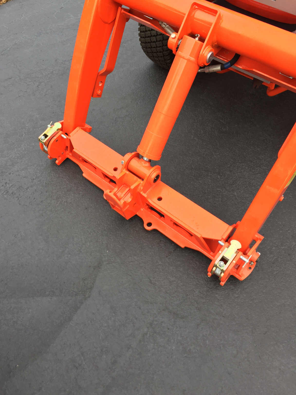

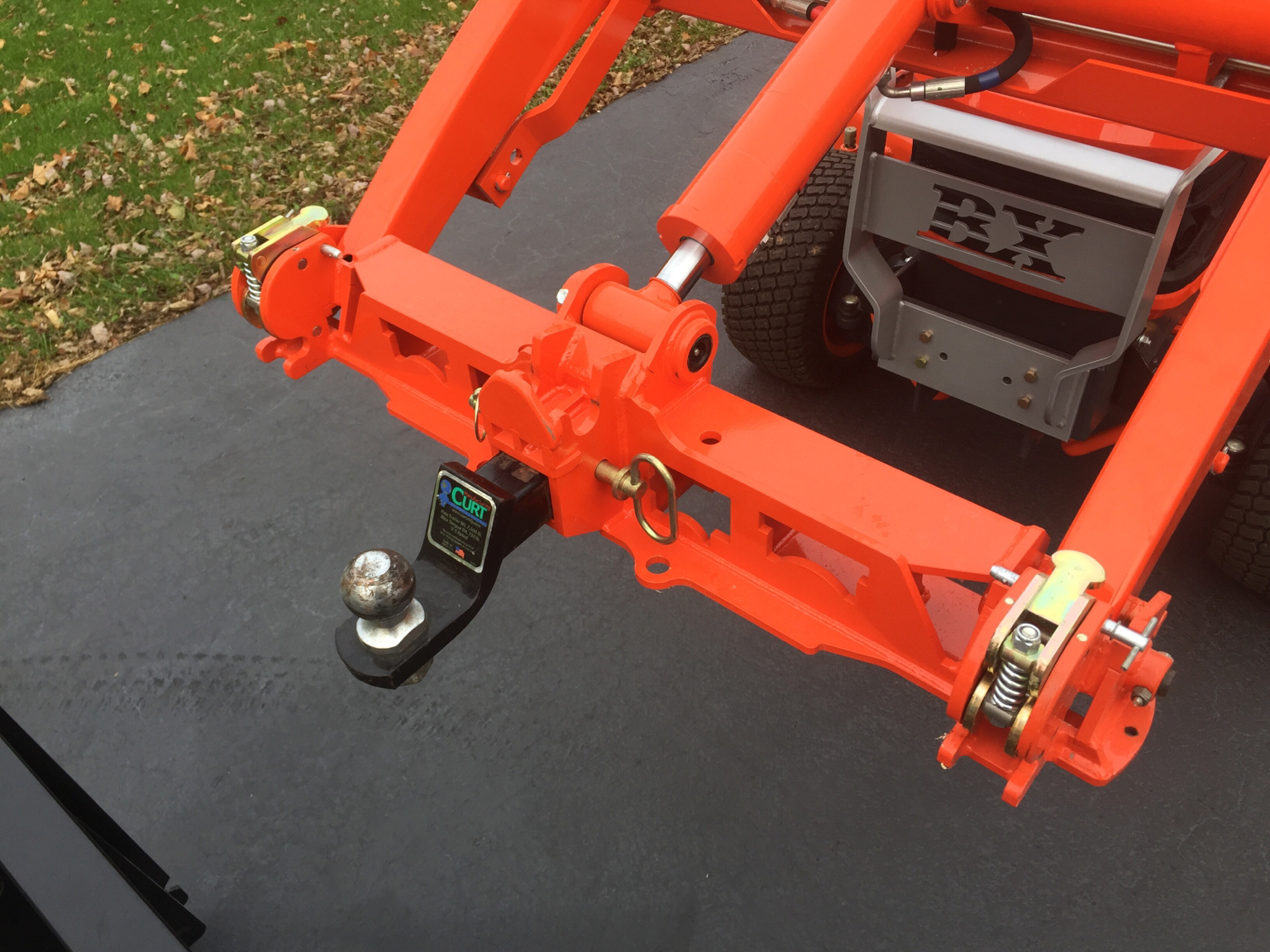

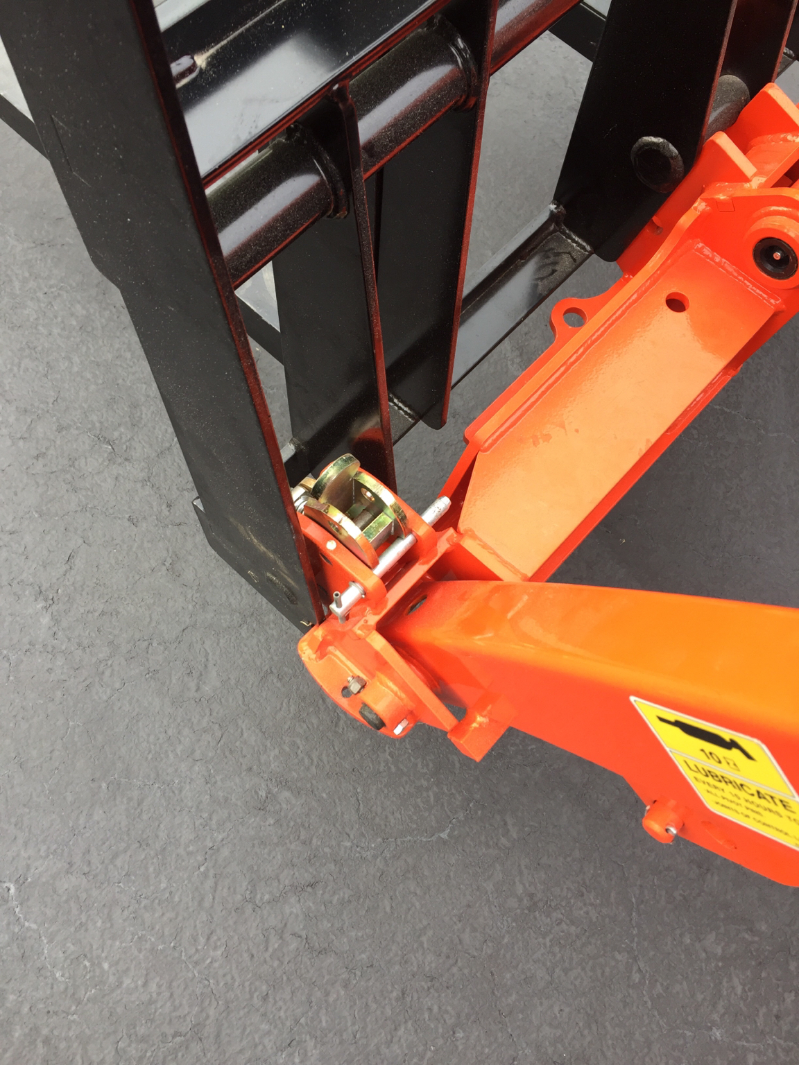

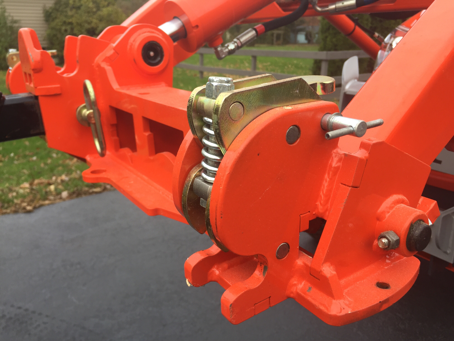

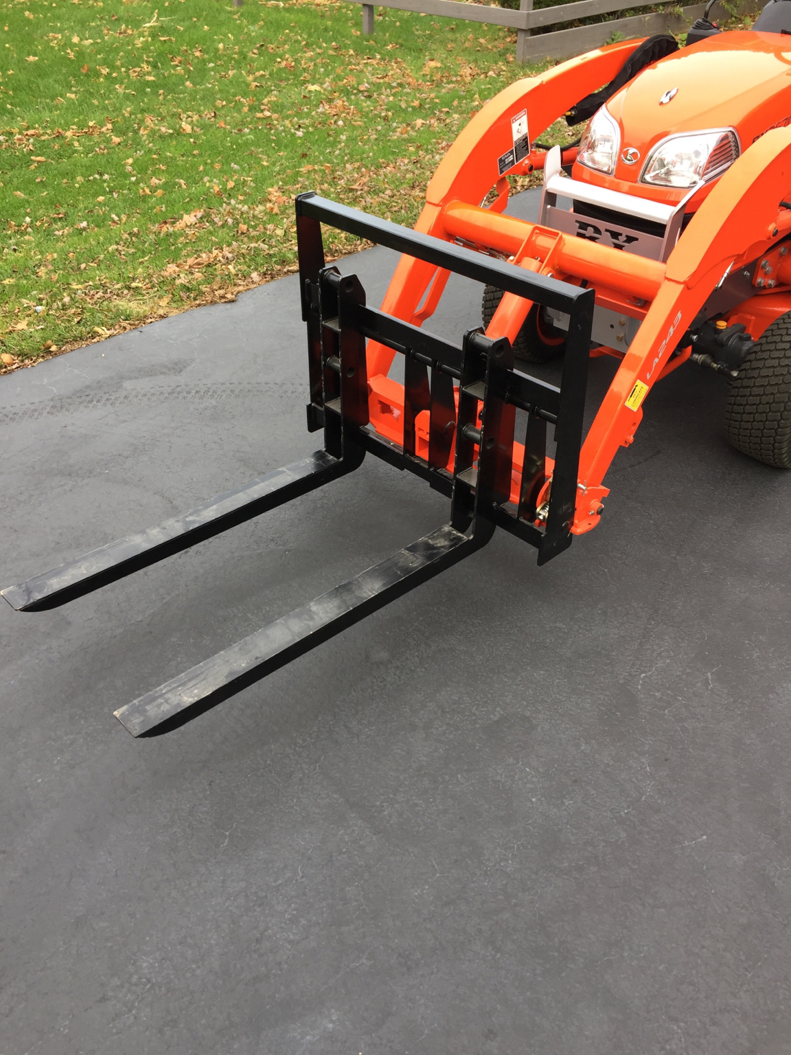

Sorry. Couldn't get them to attach before. This is Jery's setup.
As you can see, anything on the forks close to the bulkhead is just as good as the bucket... it's not far out, unless you chose to be.
The forks are light... maybe 30# each, at best, and are removable. I love the quick flip lever to lock and unlock. The QA has a pin for safety, but if I'm just moving the forks or bucket from one place to another, I don't even flip the lock or put in the pin. The weight of the bucket, blade, or forks keep the attachment in the QA.
Any questions, ask away!

Thanks for the pics! That is a nice looking set up. I do have a few questions if you don't mind?
-Any idea how much bucket lifting capacity is lost by what appears to be 4" or so added offset by the QA assembly?
-I noticed in one of Jery's you tube videos that the fork carriage is made to also be used on the 3 pt, is your fork carriage made that way as well?
-It seems you did your share of spec comparison/shopping, did you check the QA set up by Ai2 products? I think it's called the BX quick-tach, it seems very similar.
Overall added weight is real important to me since we are somewhat limited with the BX - even though it is one tough little tractor!
Thanks again!
/ BX front quick attach and forks? #37
I don't think you'll recognize any loss with that QA offset. That's not enough offset in my book for the bucket to be compromised much. You won't find any product short of #9 lead buckshot that will max out the bucket of you are lifting with common sense.... dirt, gravel, stone, mulch, etc. the bucket capacity isn't really large enough to cause issues for me. Yes, it might work it digging into a pile of CA-6, but thats usually operator error trying to bite too low and deep into in the pile.
I just moved pallets with over 800# of retaining wall blocks on each. Yes, I piled them close to the bulkhead, but no problems. 600# on the tip of the forks is not an issue either, and that's about 36" out in front of the pins, BUT the rear gets light. I only move that kind of weight slowly, and just off the ground.
Yes, Jery's forks can be used on his 3point Pal. It's a carriage on the 3pt that has a removable solid rear blade. The same forks I have store on the carriage out of the way until used. I want the carriage, but have no use for the blade, and want to integrate a 2" receiver into it for my trailer and other uses, but Jery can't do it because it conflicts with his blade. I'd have to improvise... no problem. Still thinking about it.
Ai2's QA didn't impress me. I like the solid built QA from Jery because of quality, the quick-flip locks, the 2" receiver, and the ease of hookup. It weighs maybe 40-50 pounds, I'd guess, and I find the receiver will allow me to make attachments for projects, like tined forks for raked grass pickup, crane poles for lifting, special forks for lifting things in tight spaces, adding my dethatcher as a QA, plus ease of moving my trailers.
This is my second QA from Jery. I like the BX model better than the one from my B2620. Same type and construction, but I can flip the locks easier and the throw is shorter and they snap into place, and I can flip a 2" drawbar around backwards in the receiver out of the way for use when needed.
His forks are the lightest, and moveable. Very easy to install. Mostly, I pop the forks themselves off by hand, then do the frame by hand. They all weigh peanuts.
Any other Q's, just ask.

What brand pallet forks are those? The forks on his website look to be fixed (can't move in/out). I am interested in Jery's QA. Does it work with the BX OEM bucket without modification?
/ BX front quick attach and forks? #39
They are Jery's. They ARE movable. Absolutely NO mods are required. I switch between the OEM bucket, front loader blade, and forks in a matter of seconds.
Jery and I talked when I bought my first set. I needed them movable. I think they are his standard now. I suggested he paint them black because they would be easily touched up instead of trying to match the orange. Lone behold, when I met him to get my set for the BX, they were black!
Jery's got some amazing stuff. He really needs to get his website up. I think he's losing potential business because he's not advertising. His fit and finish and welding is PERFECT. You'll swear it's done by a programmed machine, but it's all done by hand.

Thanks Robert... looking to hear back from Jery soon! Did you ever figure and recall the weight comparison between Jery's and Kubota QA/Fork set up? Kubota set seemed heavy and expensive for a BX user.
