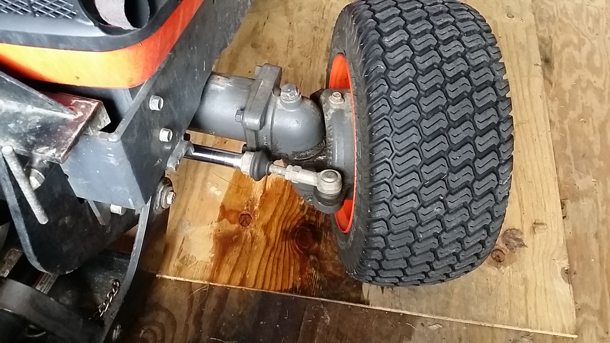

Gents, please take a look at my leaks and tell what has to be done to resolve. TIA.

Your pivots seals are definitely bad. Not a hard job to replace them (<$50 ea.) yourself. If you have the workshop manual it has a good procedure. YouTube will have some vids if you don't have the WS manual.

Thanks, I try Utube.
   / BX Front left axle seal leaky! #7
i just did both mine..the pto cover is the pefect size to knock those rings on w/o denting them..cuz they sure are flimsy to dent
So **** Lame!!!!!!
How lame can I get? I went and replaced the pivot seal but, the WRONG SIDE!!!!!!!!
I need to think............Auto pilot mode is not as sharp as used to be.....F$$$$$$$&&&&&&K!!!!!!!!!
