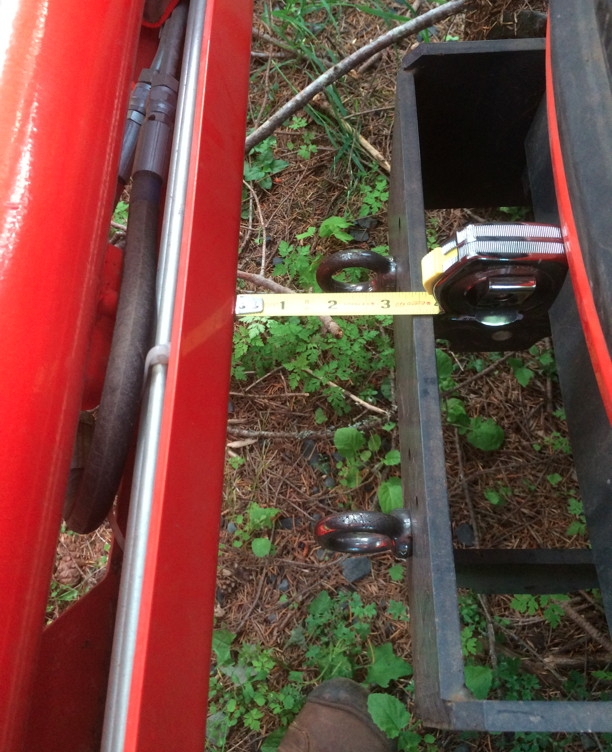

A starter idea:
If the receiver was just below the front frame, and not sticking out, it could stay on with the FEL. There is only about 3 inches between the frame and the loader crossmember on my BX, when fully lowered.

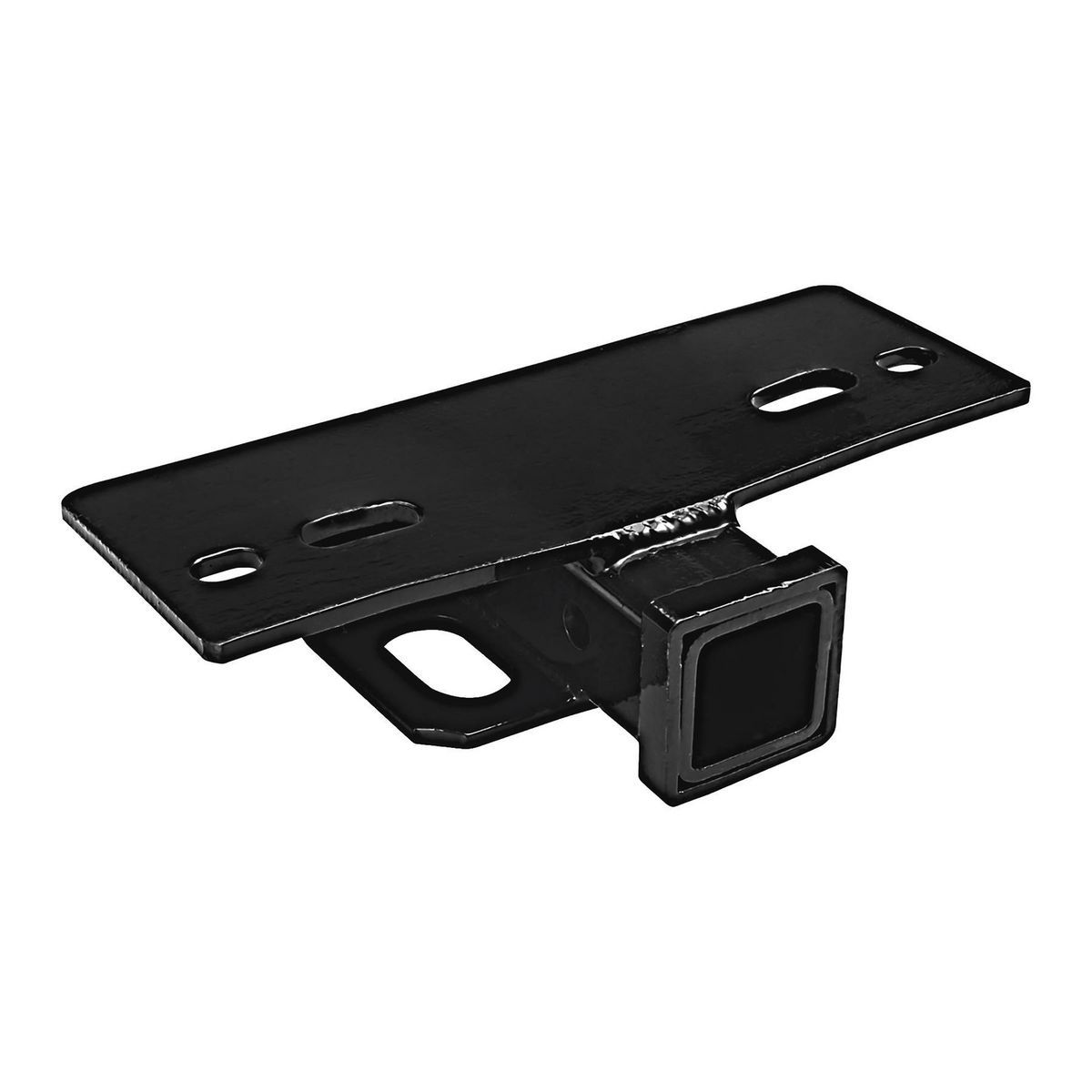

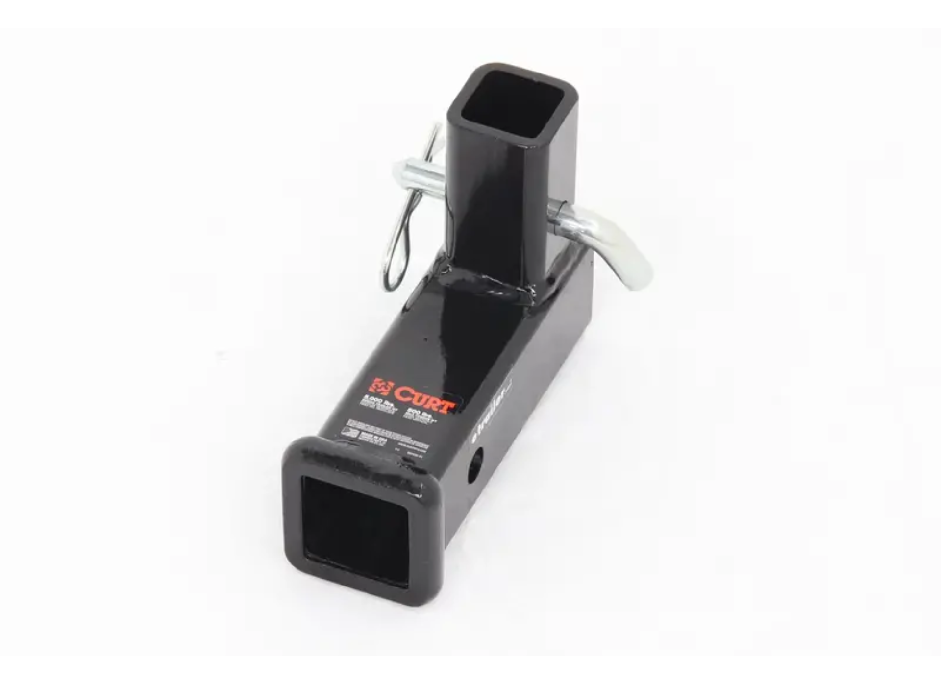

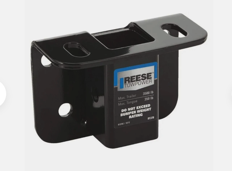

   / BX front carry shelf #4

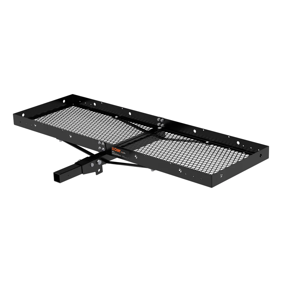

Mount a step bumper receiver vertically behind the frame, then use this. Easy to take off, and no interference with the loader crossmember.
Narrow one:
Wide one

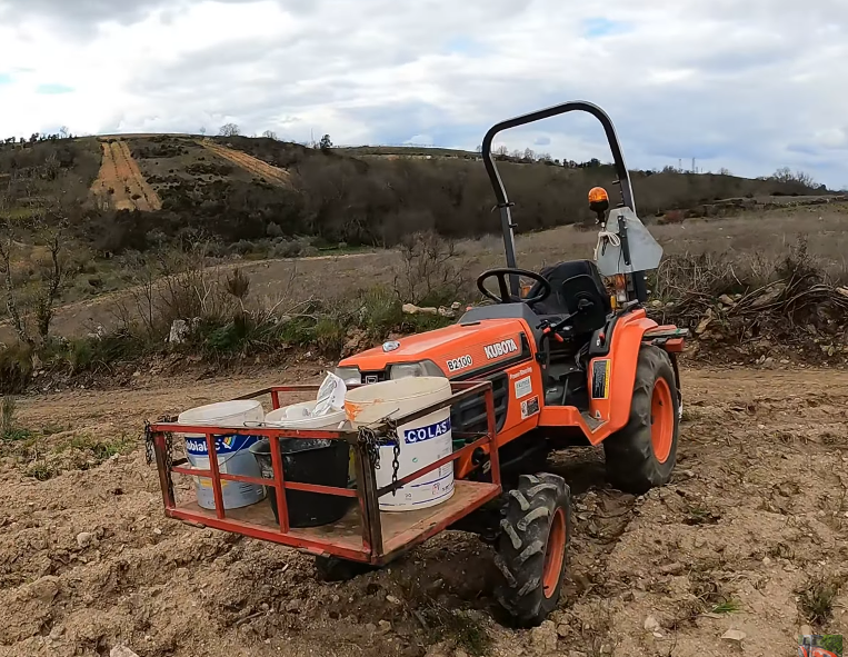

   / BX front carry shelf #8

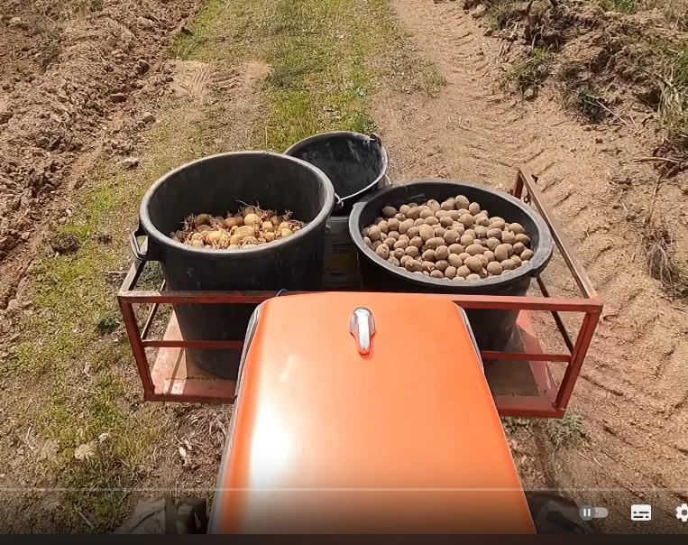

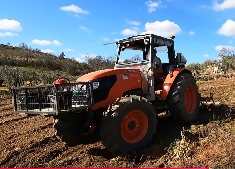

A local farmer had a fabricator make him a front mounted box/shelf. He uses it to haul tools, potatoes, fertilizer, etc, when driving between the various fields he farms.
The box is interchangeable between his small Kubota B2100 and the bigger M7060. Both tractors have two pieces of square tubing mounted horizontally, facing forward and spread apart on the front above the front weights. Then the box just slides has two pieces of square tubing as well that just slides on the other pieces of tubing on the tractor. A pin trough both tubes keep everything in place.
It can easily be removed and while his tractors don't have loaders, there wouldn't be any interference with the mounts.
