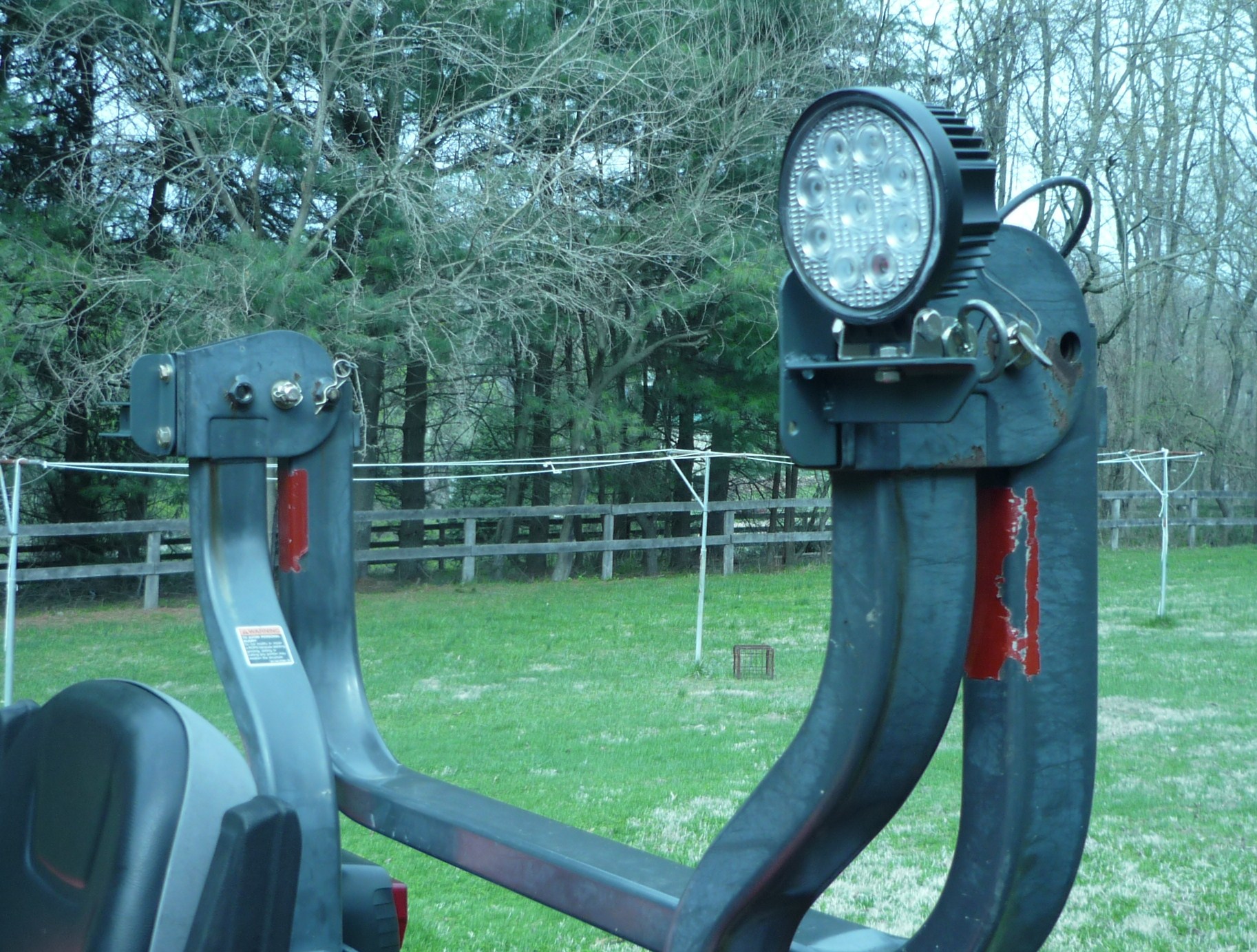

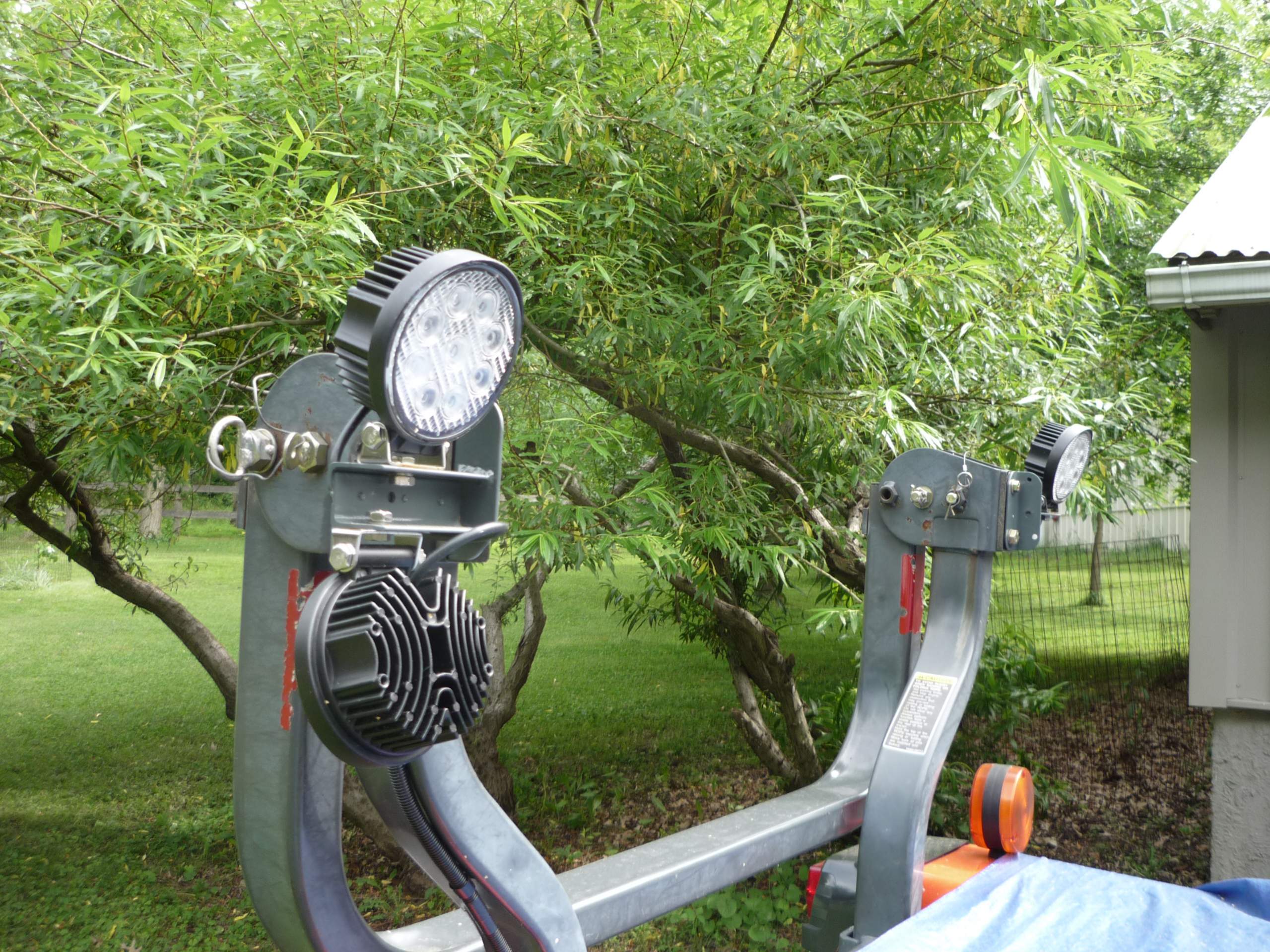

Here's a couple of photos of how I mounted my lights... (before anyone comments on using grade 8 hardware, let me just say I wanted to match the ROPS hardware)
