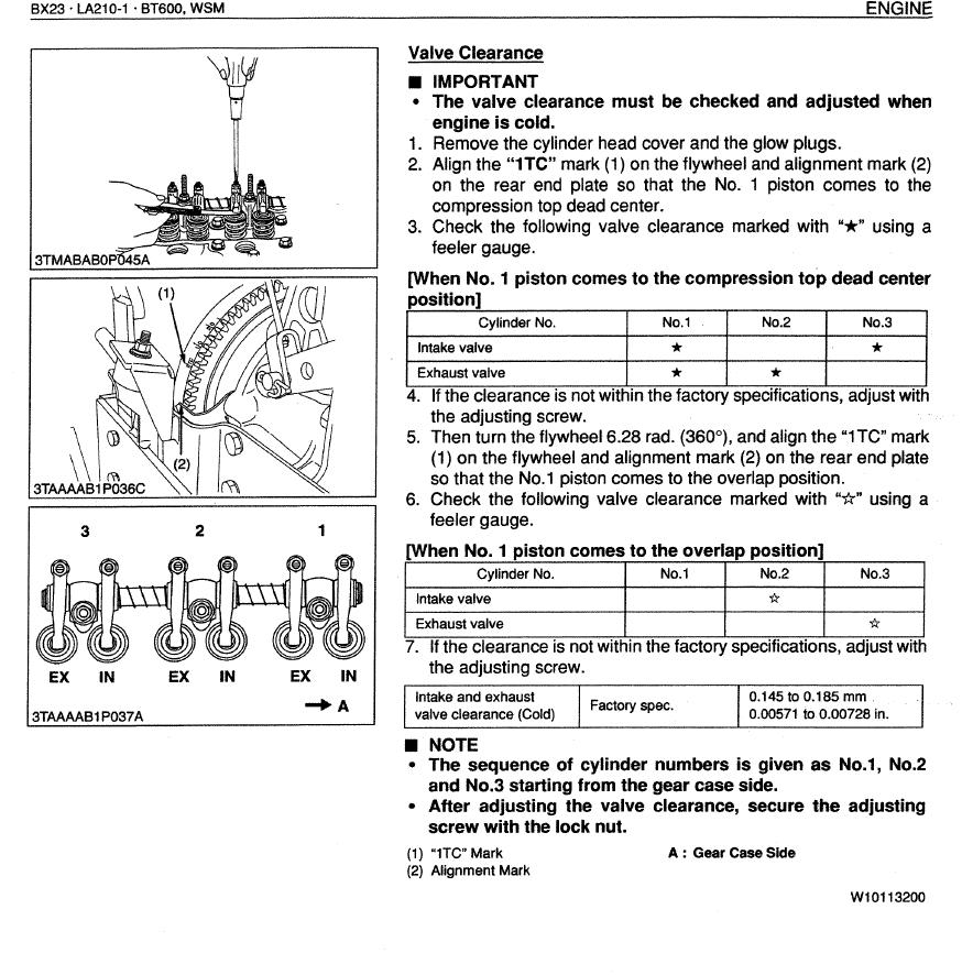

My Kubota BX 1800 is overdue for an engine valve clearance adjustment. The manual says take it to a dealer however my dealer moved out of town and I don't want to haul the tractor 50 miles to get it done. I this something I can do myself with some instructins from the wise wrench fairies that inhabit this site or should I haul the tractor. Thanks!

Even though it is listed as a scheduled maintenance item, I don't know if I'd worry about it unless there was a reason, i.e. loud tapping and/or a noticeable drop in performance.
That said, if you want to go ahead and check the gap it's not that complicated to do.
The attachment is for the D905 engine in a BX23 and it might be the same for the 18hp engine.
Good luck

Thanks for the picture Wolfant. That will help alot. The dealers mechanic will probably be able to tell me if the 1800 is any different than the 23. The reason I want to do the adjustment is not because it is making noise or losing performance but becasue that is what the maintenance schedule suggests. I try to stick with the schedule as closely as possible. Everyone is probably right that this is not neccessary but half the fun of machines (if you get your head into it) is maintaining them. Heck you eventually run out of work to do with them so this gives me more machine though not seat time. Thanks!

Having done countless valve adjustments on my motorcycles, I have seen that (at least on those engines) the clearances will close up over time. It looks like the BX engine has a screw/locknut arrangement, as opposed to the shim under bucket. That makes this a MUCH easier ordeal.
If your engine is truly up to the hours that call for an adjustment, I say go for it. Make sure the engine is cold. Remove the valve cover. Check the lash as described in the manual, and first see if any are out of spec. If they are, it's a simple adjustment. Loosen the locknut, turn the screw, re-tighten the locknut.
The last thing I would recommend is before putting it all back together, roll the engine over a few times and then make one final check with the feeler gauges. On my bikes anyway, I have found that from time to time, and for whatever strange reason, a final adjustment is needed.
As far as "if it aint broke don't fix it," that does not apply to maintenance. As the valve lash closes up, the lifters get QUIETER, not louder. There is a reason that this operation is on the maintenance schedule. When the clearance disappears, the valve tulip no longer contacts the seat, and therefore will not cool. It will then burn up. I have also seen this on my beloved Bavarian motorcycles.

Most of the time, a readjustment is necessary because the lifter was on what is called an acceleration ramp portion of the cam lobe.
To set valves accurately, you need to have the lifter contacting the cam at a point as nearly opposite the top of the lobe as possible, ie the base circle of the cam. There are various ways to do this but the easiest is this:
Turn the engine in it's normal direction until the exhaust valve just starts to open. Set the clearance for the intake valve.
Then rotate the engine, again, in the direction it runs, until the intake valve has just finished closing. Set the clearance for the exhaust valve.
Repeat for each cylinder.
This is easy to visualize if you think about the 'mouse ears' silhouette of the intake and exhaust cam lobes as viewed from the end of the cam.
