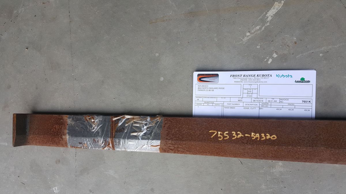

This is the Kubota bolt on cutting edge on my new BX2380. The underside of the bolts are round, flat allen socket and recessed up into the cutting edge e.g. the bottom of the cutting edge is flat the bolts don't stick out.

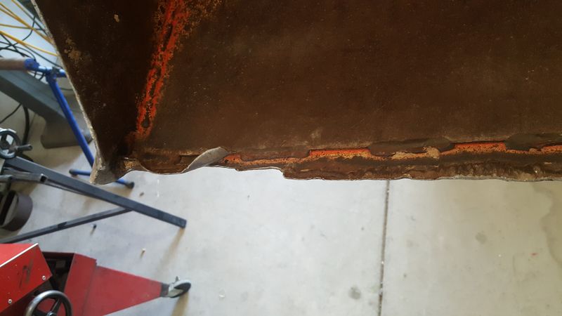

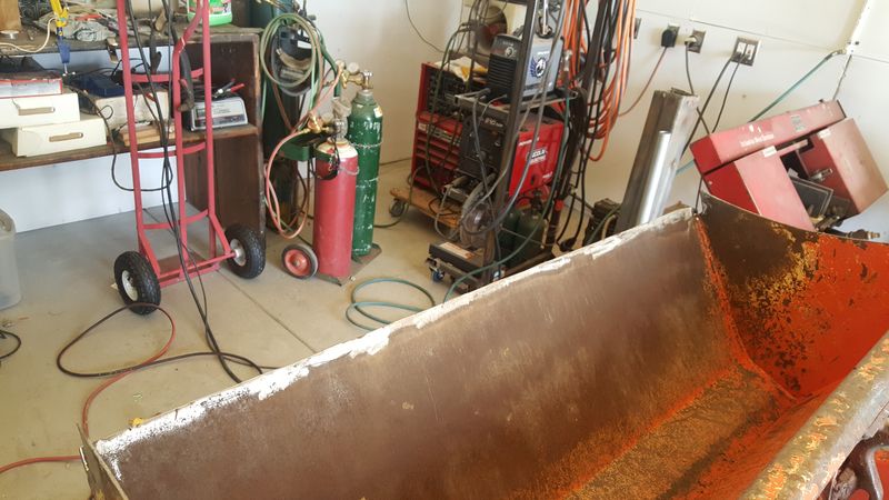

Being my edge was so bad, it needed a new one. I tried adding weld material to the edge to get me by for a few days but it didn't last long. Adding more weight with an additional 4"x1/2" plate was something I would rather not do. This thing barely lifts a bucket load of top soil as it is. LOL

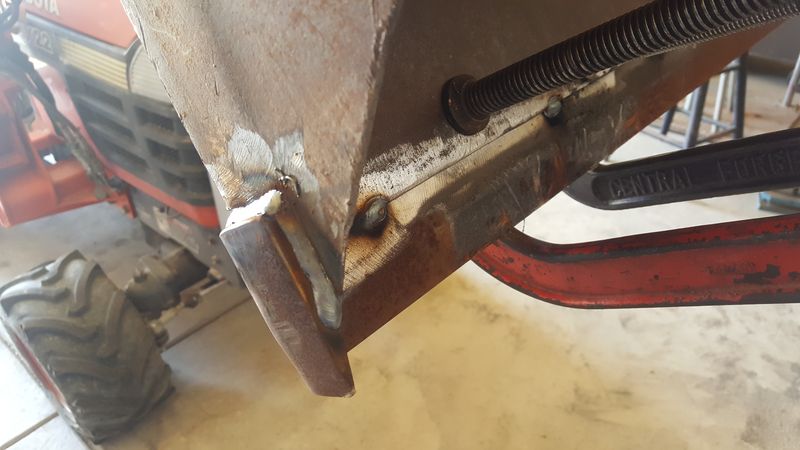

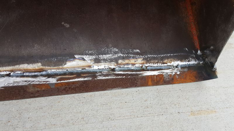

This took about 3.5 hrs to replace even with my plasma cutter and way too much grinding. I wish it was higher carbon steel.
Ends welded and the rest tacked.
