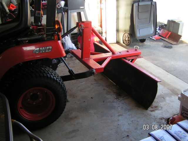

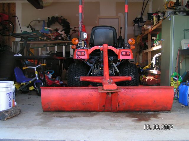

I have a full cat1 rear blade and a KK XB box blade. I got the XB because it had a slightly lower profile which allowed for greater lift height. However My 5 foot rear blade is full sized. The pins are 29" apart. I have not had any problem getting it on. Do other folks have pins widths that exceed that?

Well I was hoping to use my fathers tiller that he used on his 69' ford. But after I checked with a tape, It was over 34" and no way to turn them in!:(
That looks good Kwolf. But the stretch must make it hard to remove and install.
