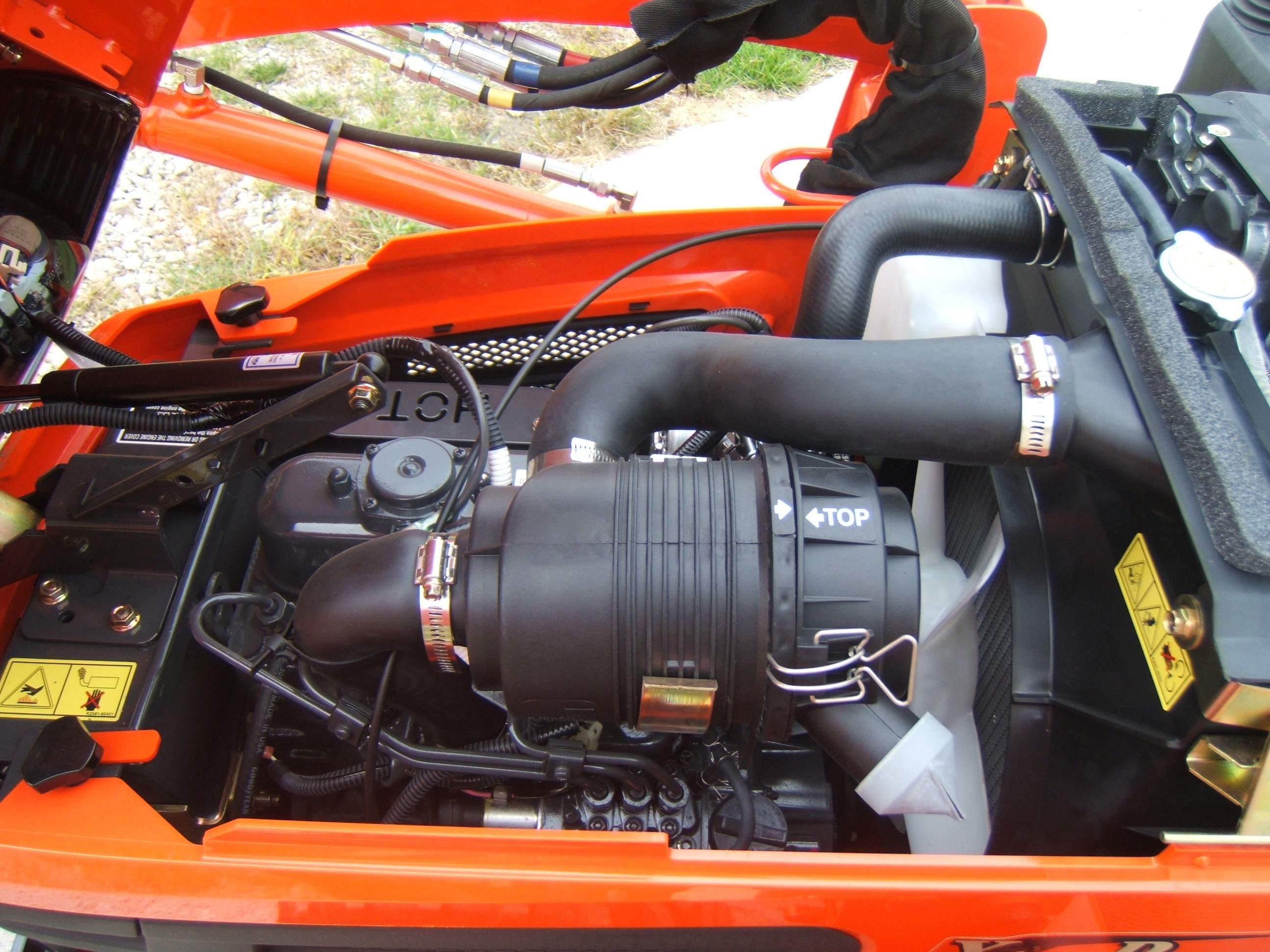

Is this the new or old bracket?

1*It must be that the posters with bracket problems own pre-2004 BXs.
2*That brings up a question:
3*How do the new brackets hold up? Volfant's bracket seems to be OK.
4* Have any broken on BXs that are 2004+?
Just did a Google search using "Kubota K2561-98210" - the bracket kit. There were lots of hits and even several hits listed threads here on TBN from as far back as 2005.
5*The information is out there and has been for some time.
1*Nope the bracket has been a quirk of all years and models of BXs.
2*3* That's kinda hard to answer because some broken ones were replaced with new style ones while others were replaced the old style brackets.
This plus inadequate follow up makes it almost impossible to answer your question.
4*Yeah lots of em.
5*I was tryin to tell ya this when I posted # 4 above.
It's nothing like what's on my 3 BXs.
