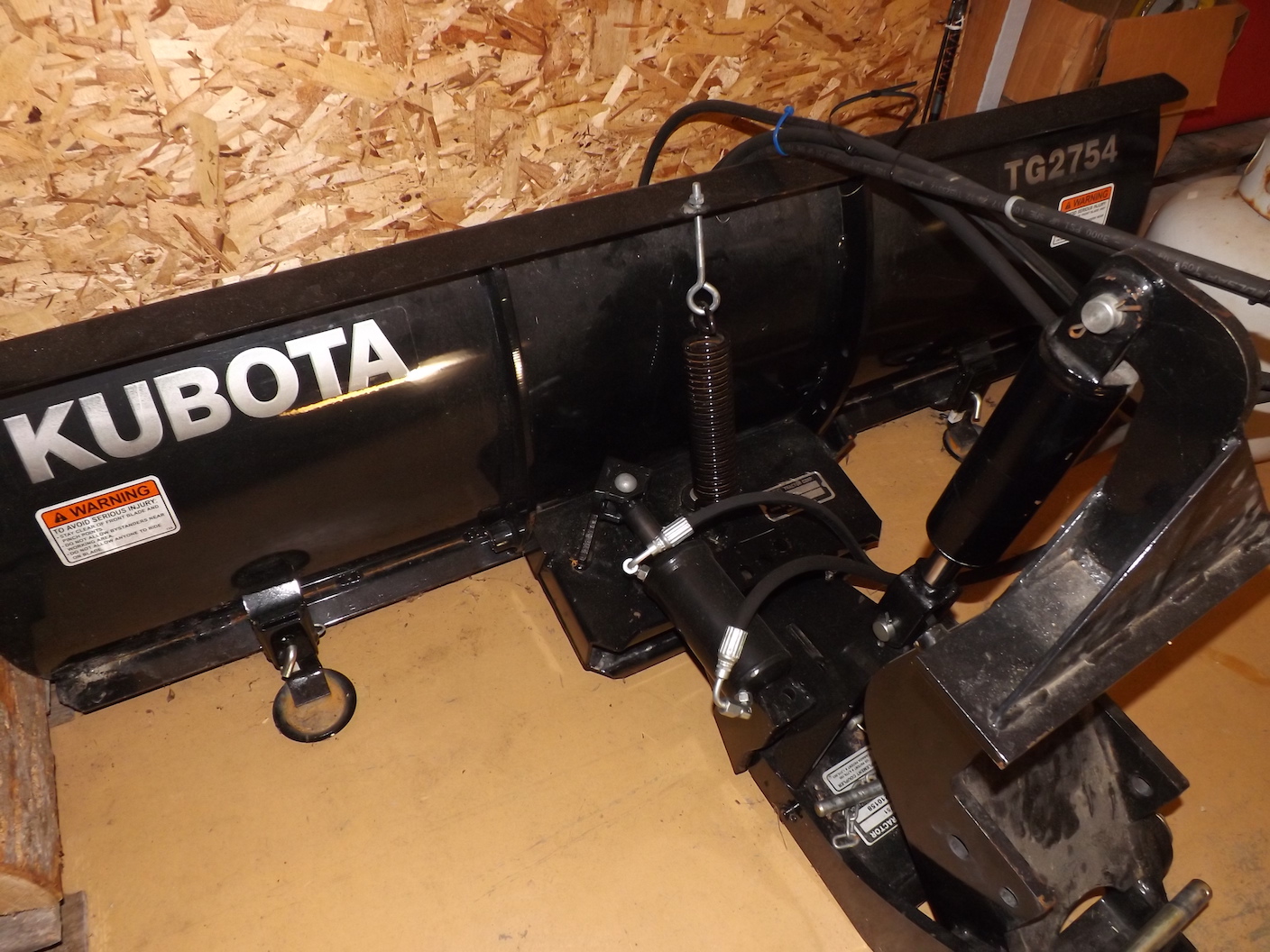

Yes, the ram is attached to the blade, via a sturdy under-carriage of steel bar to support it. Take the blade off, by backing out of the QH and the ram and its support would come with the blade. I have had all this off and on before. The vertical piston is attached to the QH of course. Two hydro lines stay with the plow portion and two lines stay with the QH.
Hope you guys can see from the photos what you want to zoom in and see. It's all black and not easy to get the detail you might want. Gettin' dark.

BP - thanks for the pic's. Finally get to see how that 60 incher is set up. From what I can tell from the pic's, it seems the 60" angle cylinder is mounted not totally dissimilar to how I mounted it on my 54" version except that the 60" version looks to have it's own mounting apparatus connected to the blade only -an under-carriage as you say. Anyway, thanks again. Maybe this will give Andy and others a better idea on how to do the conversion.

thanks for the pics. They do help. I guess the B series blade has the most "compact" angling mechanism. The BX 60" that you have almost looks like the ram attaches to the QH like on the 54" conversions. I do see the subframe it attaches to to keep it on the blade apparatus. You could probably weld something like that onto the 54" mechanism if you really wanted to keep it all in one. But its not that big of a problem to remove it. Just have to pull one extra pin. I should be ordering the parts today. I will post pics of the conversion. Might not be till after xmas though (blade is actually a xmas gift :D)

Agreed. I don't think it matters at all, on your builds, where you put what. Not a bit.
Obviously, Kubota needs to keep hydro on the QH sub frame to provide lift for the broom, snow blower, and other attachments. In other words, Kubota's thought is to always divide the hydro lines. 2 go with the attachment and 2 stay on the QH.
On your own build, you could care less about that, until or unless you would want to use your QH for another attachment. Then you'd have to pretty much follow Kubota's plan?
