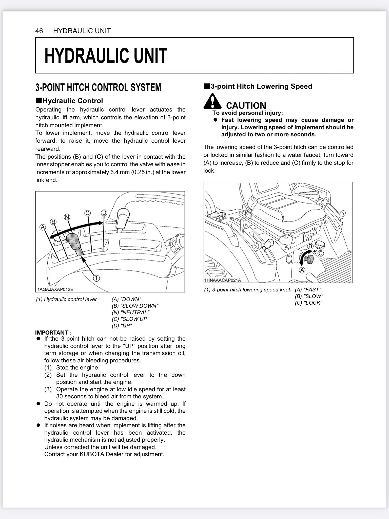

I have a BX25D but I am not sure of the levers you are refer. The is knob below the front of the seat that adjusts the 3ph lowering speed. No set stops on the BX that I am aware of.

I’m not sure it’s considered position control as much as speed control. I believe position control is being able to get the three point down to the same depth by moving the lever to a preset point for the hydro control.

To control the drop speed use the knob between your legs. Works for the MMM and the 3ph.
Here is the page from my operator’s manual.
   / BX 3pt hydro control #15
Got adjusted ! I can lower the blower very slowly now!

Dave
On the page it shows “slow down” which I think means to engage the bump stop by holding the lever toward you as you move the lever forward. At least that works for me. The stop can be adjusted by loosening the 10mm nut under the seat per my pic.
Thanks for the info.

Using the wheel valve I’ve got it so the blower drops from up to ground in 5-6 seconds. Now the blower just comes to rest instead of slamming into the ground.
