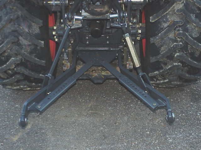

I finally got around to installing the arms today. Figured that I would take advantage of the 65 degree weather. We don't get many warm days like this in the middle of the winter. I even planted some Hyacinth bulbs that I found in the box that the arms were in. Forgot all about them being in there. /forums/images/graemlins/shocked.gif A mind is a terrible thing to misplace.... /forums/images/graemlins/ooo.gif I only wish that I knew what I had done with the attaching hardware. Had to improvise until the package reappears..... /forums/images/graemlins/blush.gif

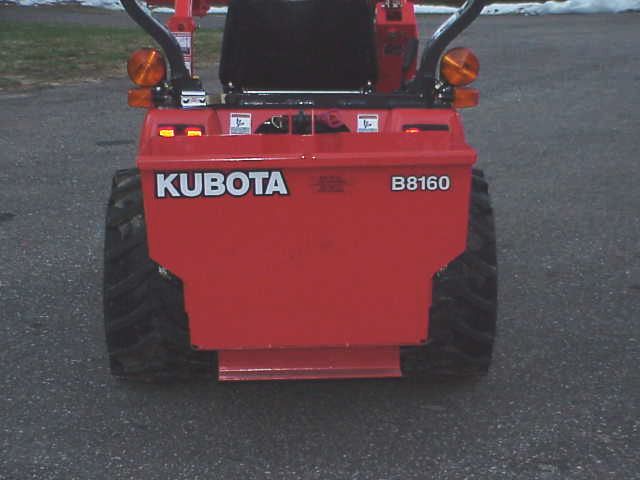

   / BX 3 point hitch arms
Picture 2

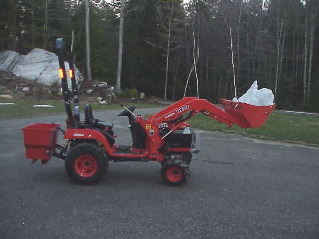

#9
I wanted to see how well it worked with the additional weight in back, so I attempted to dig into the pile of frozen snow. Works better than having the backhoe on for weight.. Picture 3

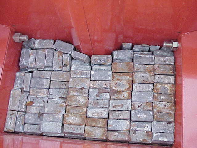

My weight box with weights.... Picture 4 /forums/images/graemlins/blush.gif All 506 blocks @ 1.25# = 632.5 pounds... /forums/images/graemlins/shocked.gif
