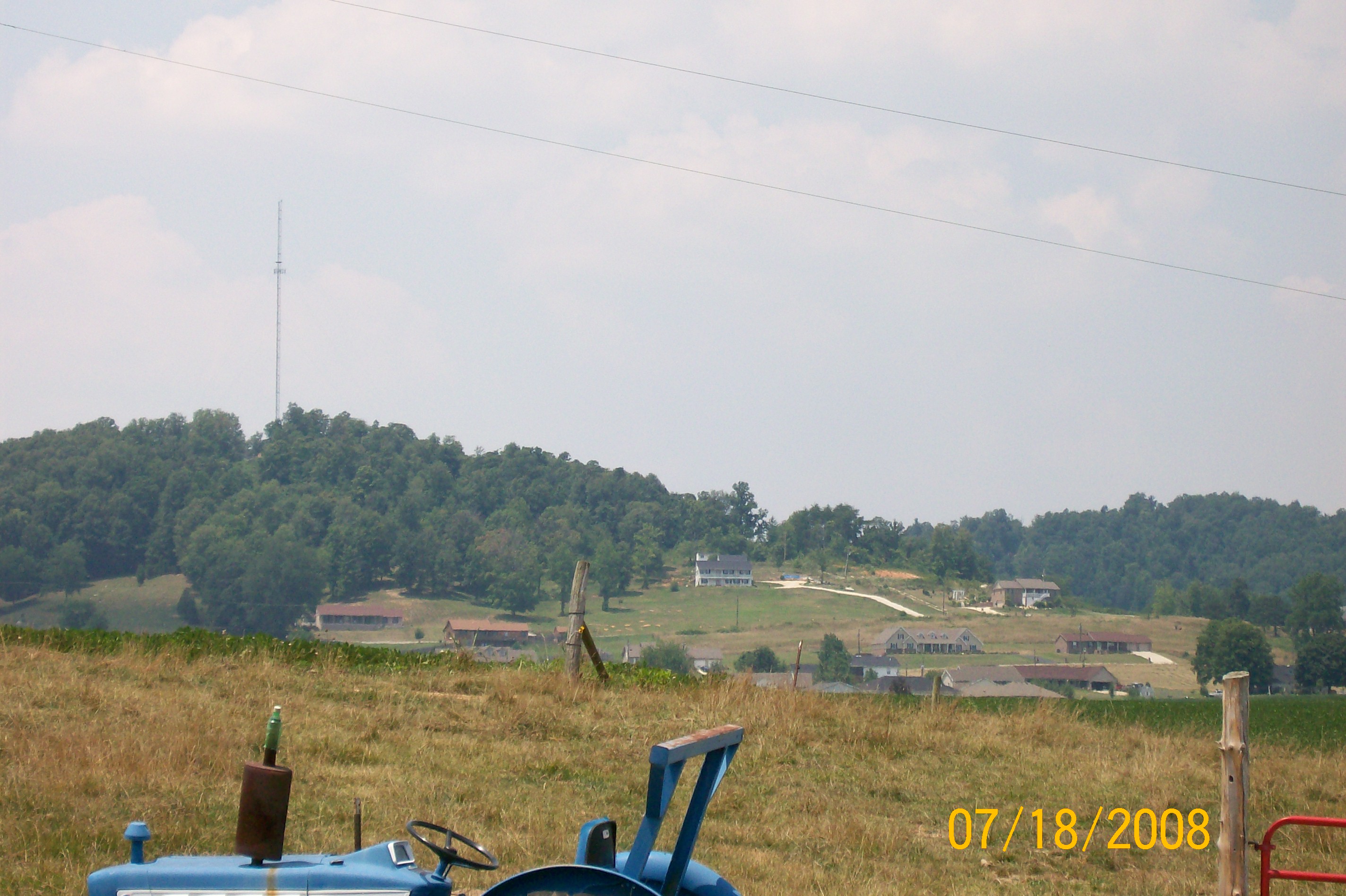

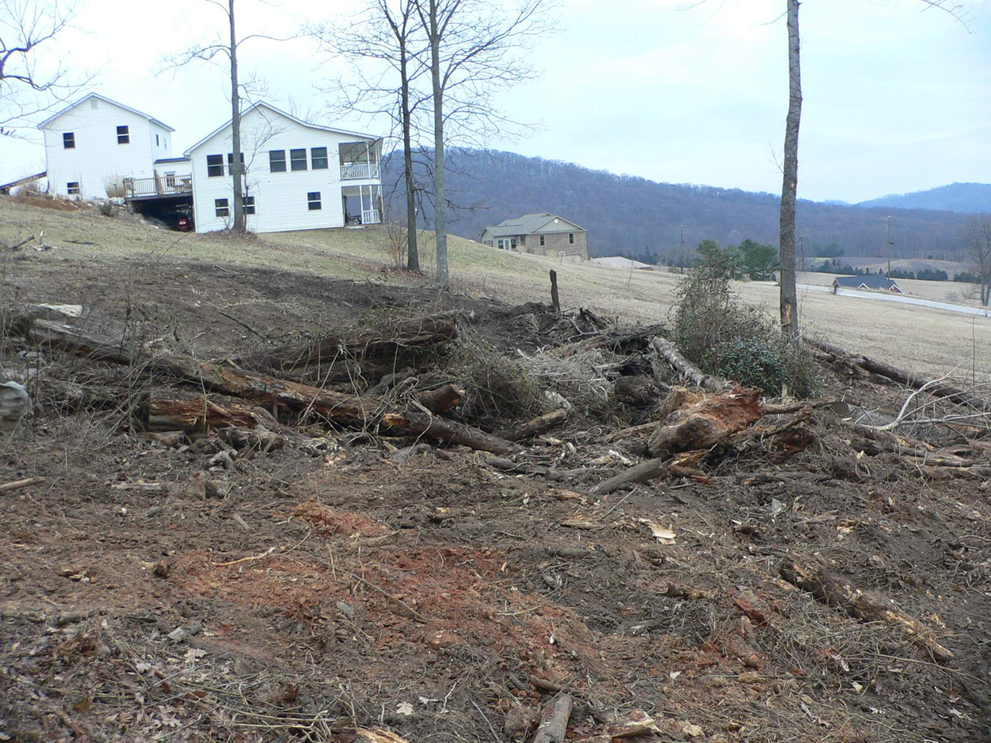

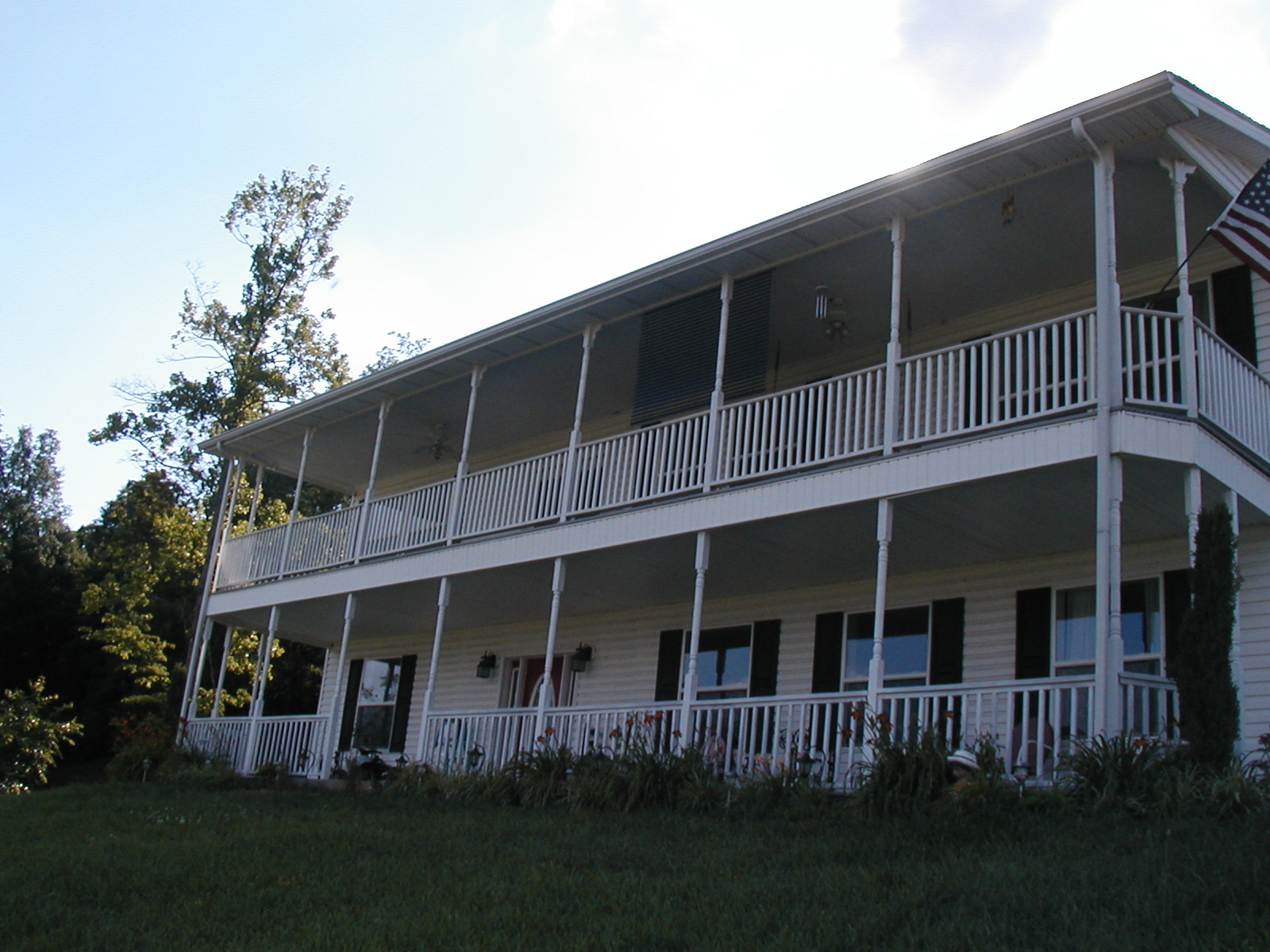

I believe "feel" is the key word. Yes. Here is a picture of my house and the yard immediately in front of my house does a fairly steep drop. I would never drive across it on my B3200 FEL. I drive across it slowly all the time on my BX's. I drive across parts of the rest of my land with the B but I'm not as comfortable as I am on the BX. Will drive straight up and straight down any of it on my B or even the L but not across it. Was very uncomfortable on even more of it with my previous L. Love the B for power and ground clearance but the BX's are grand as you know. I don't know if sitting on the upper edge of the seat when crossing a hill really helps but I feel safer doing it on the BX than I do the B. Guess I know my 200+ lbs won't really do that much for the B and maybe it will for the BX. Hope I never find out I'm wrong!:) Go to a Kubota dealer that has a sloped or ditched lot and drive a B and you will "feel" the difference and you may be OK with it or come to Somerset, Ky and I'll let you drive mine and see what you think.
