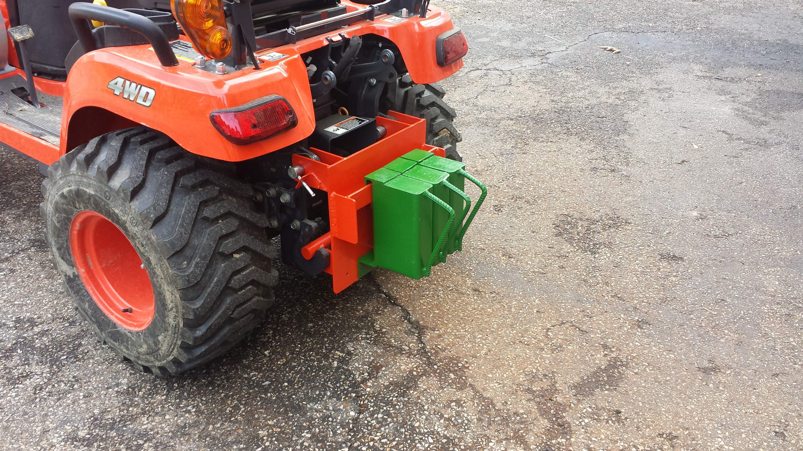

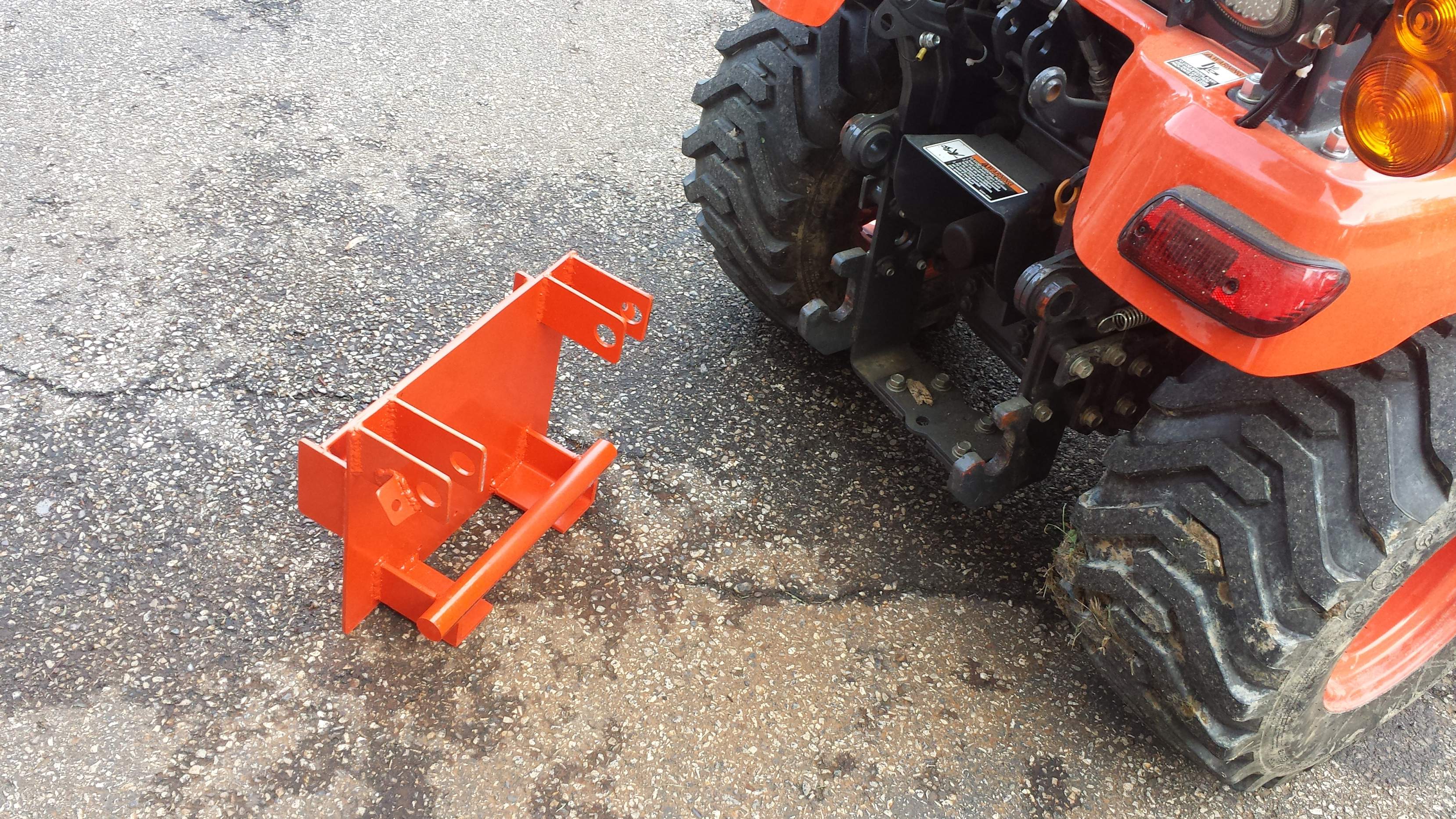

Howdy all,
Cleaning up the garage sometimes means making things out of all the "stuff".

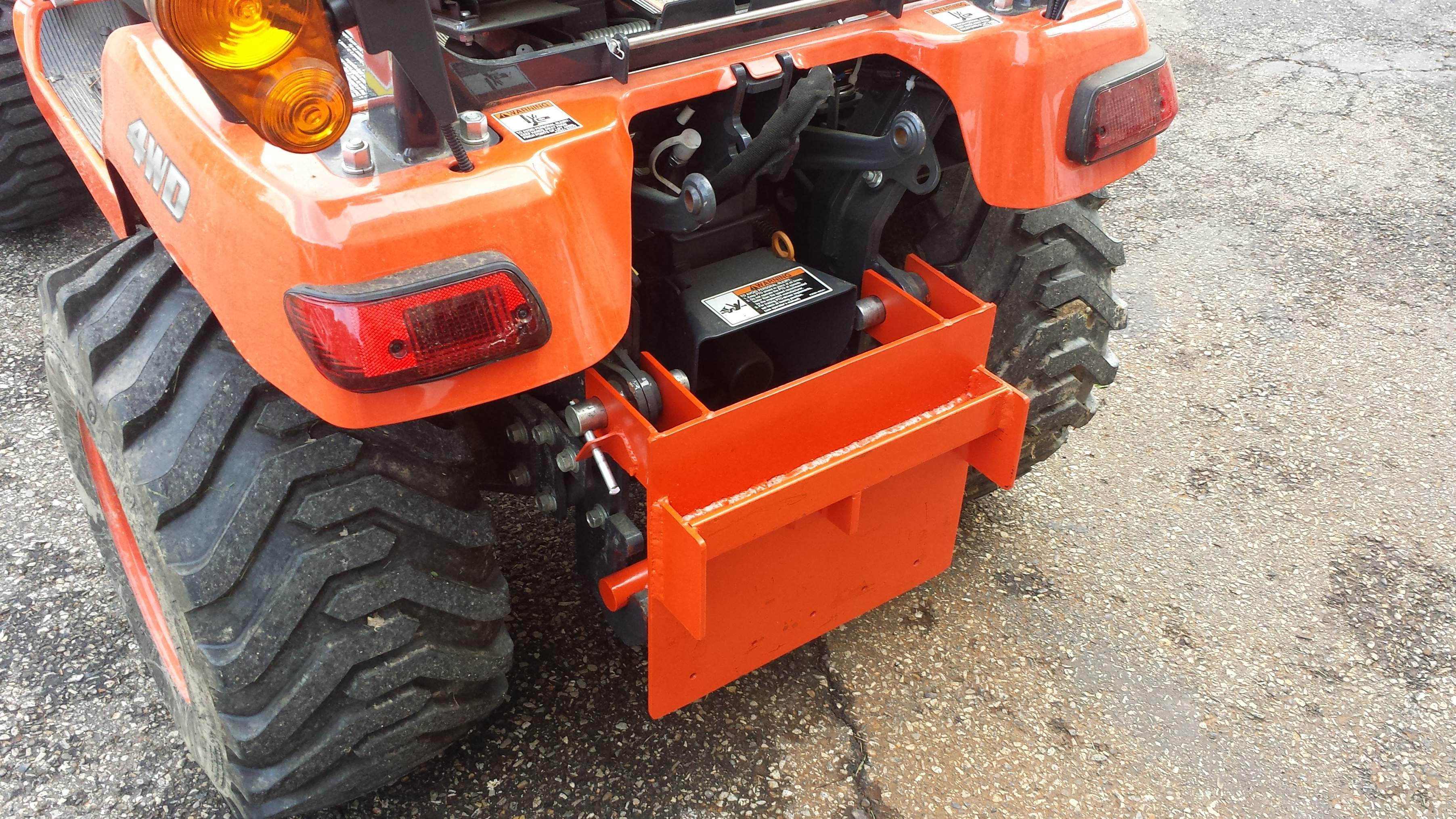

That's what has happened here, I made a weight plate on which I can hang many things.
It mounts on the backhoe brackets.

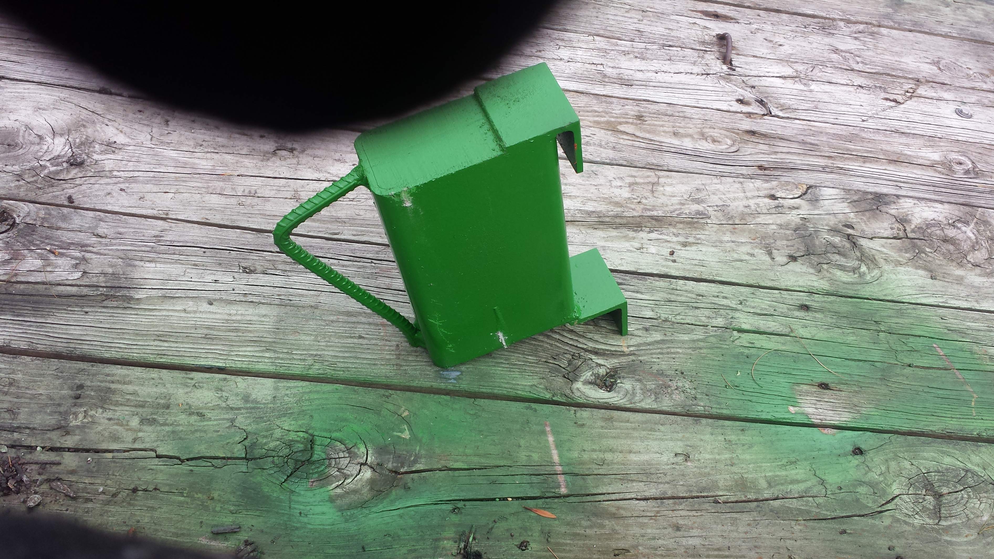

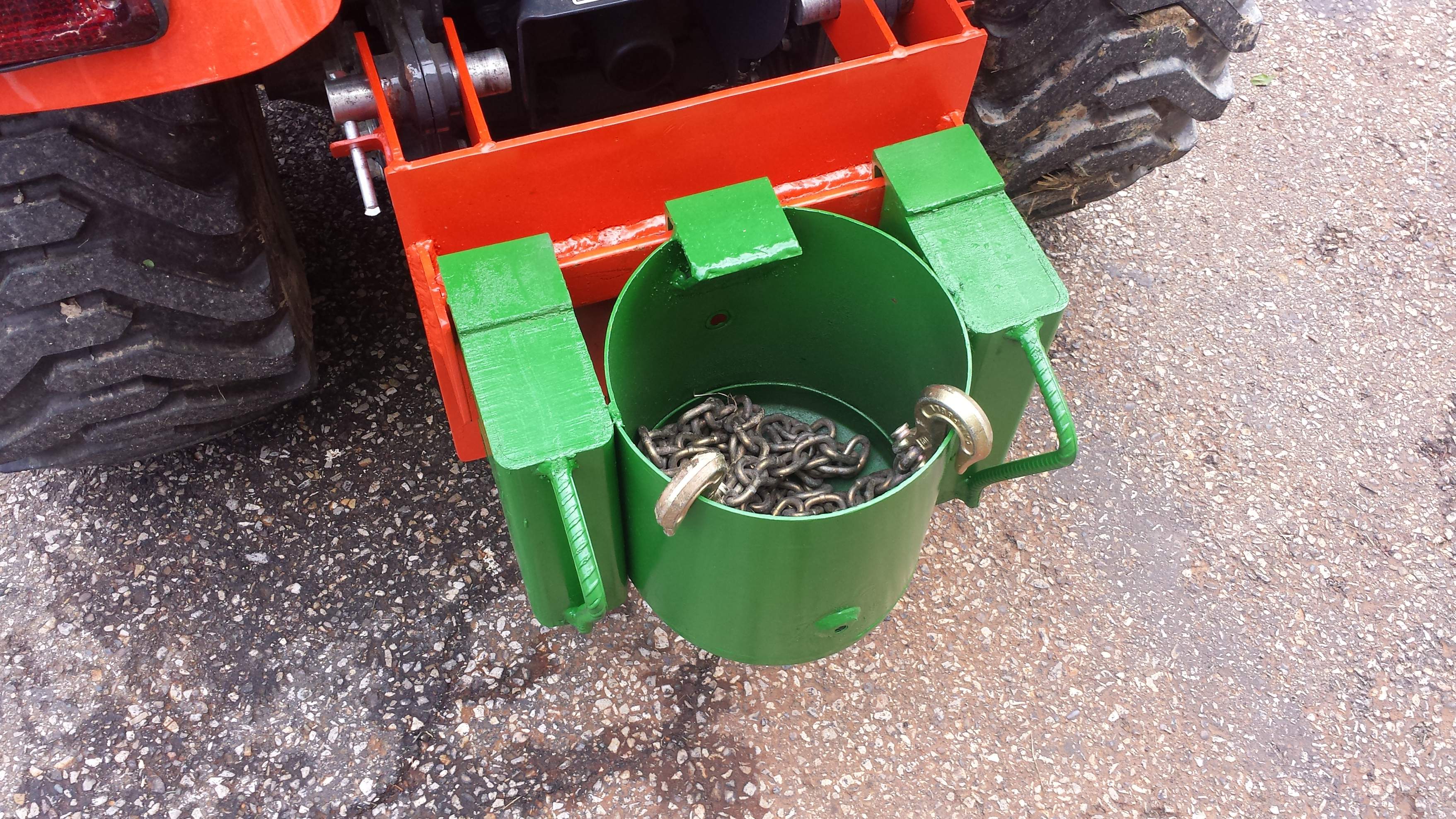

Right now I just use it for the weights and chain bucket seen. It can accommodate 5 weights.The weights are filled with melted lead provided by a local tire shop. They weigh about 70 Lbs. apiece.
The weight tubes are topped with Hydraulic cement. The Green is for contrast and Elimination of another can on the shelf. ( I like all colors )
The weights and the chain bucket are secured on the bottom with a 3/8 bolt. The main plate itself is threaded to eliminate a backing nut.
One draw back of course is it can't be on with the hoe.
Now let me look in the Junk pile and build a few more options....

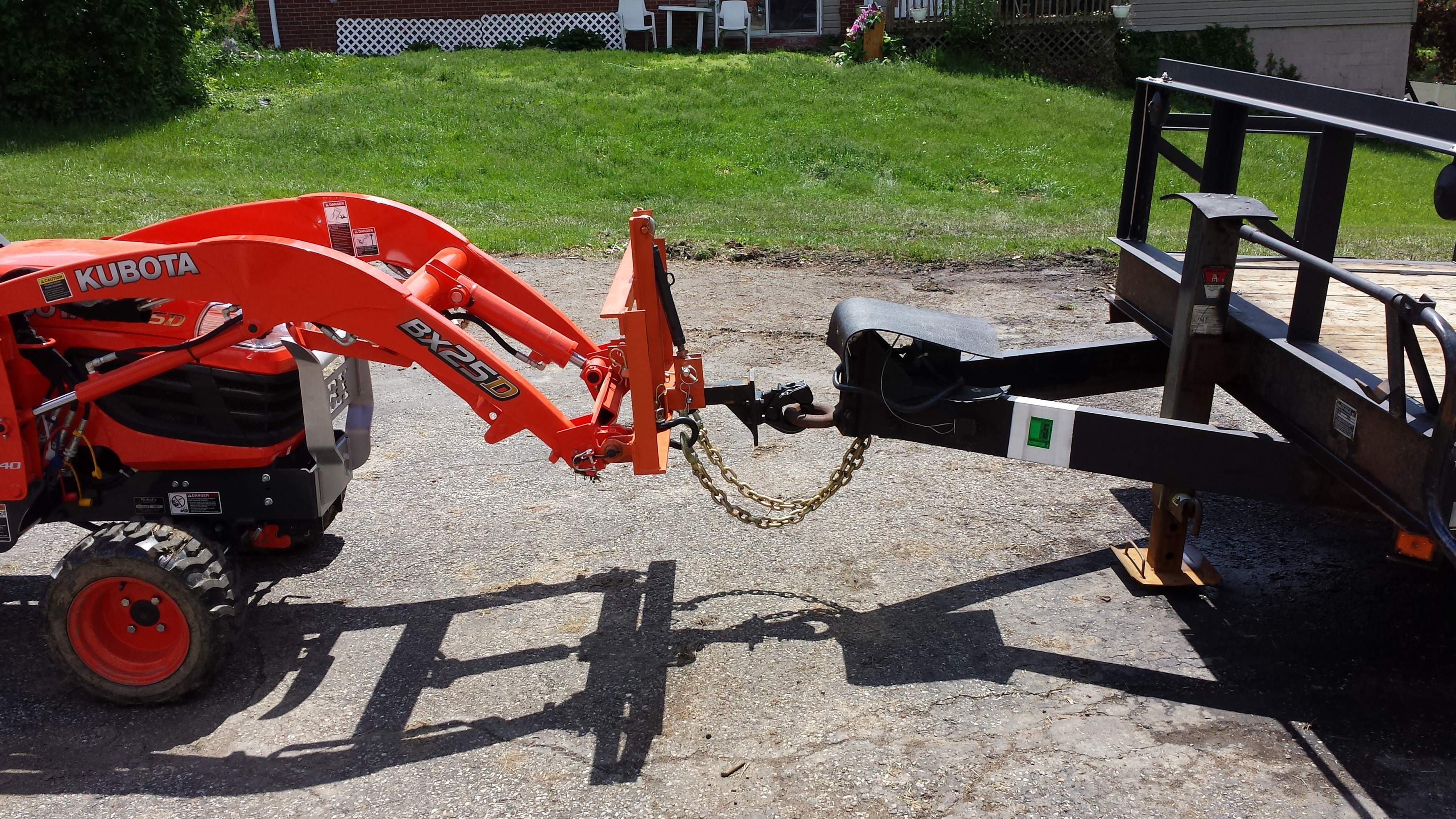

Is there any way to add a 2" receiver that you lift with the 3pth? I would be lost without a trailer ball....even my hoe has provisions for one when it is installed...
   / BX 25 Weight / Options Plate
I think it could be done, I move most of my trailers on the front end loader with the help of a pallet fork / Hitch adapter.
The main plate sure perhaps also be 3/8 inch.
It is so easy to place trailers when looking forward.
Pic attached.
